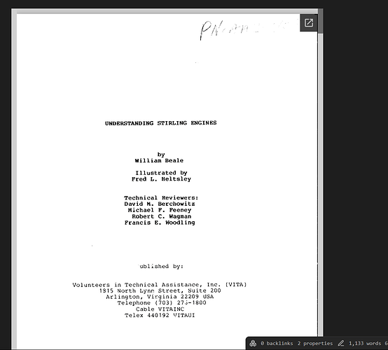

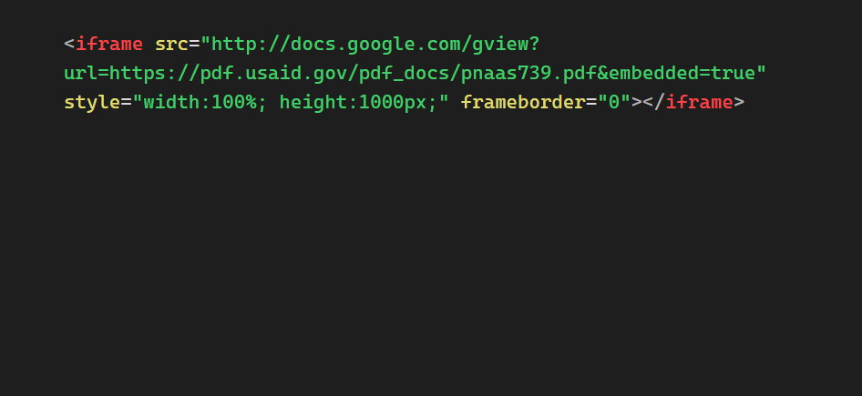

I think I found a fix. Use this syntax for your link:
<iframe src="http://docs.google.com/gview?url=https://example.pdf&embedded=true" style="width:100%; height:1000px;" frameborder="0"></iframe>
The reason it works this way is that embedding it just using plain iframe triggers CORB (cross origin read blocking ), which is a security protocol that prevents some code from running in your browser for protection. However, you know your code is just for showing a PDF and that the PDF is safe, so you use google pdf viewer to open the PDF. I found the syntax for doing so here .
I wish someone makes this a plugin like the convert-url-to-iframe . I think that the implementation will be very similar.
Example
