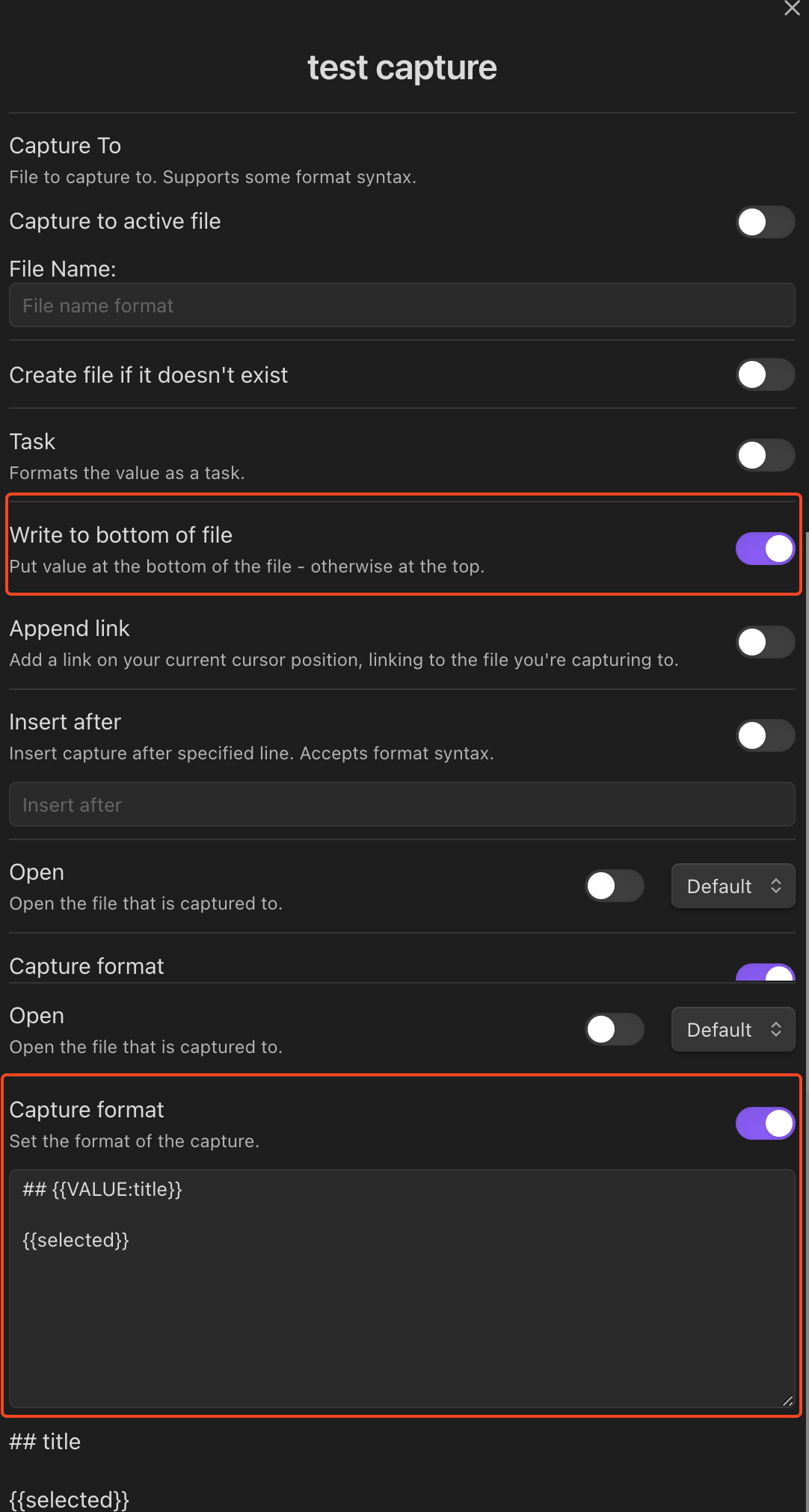

Workaround is to use QuickAdd captures [1]
This doesn’t configure which file should be used to store your selection. Make a selection i.e. open your link and press ⌘A then run your QuickAdd capture. QuickAdd will ask the file and a title for your heading.
