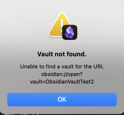

Current functionality is that if a given folder was already opened as a vault, then it would work with command
open "obsidian://"`pwd`
But otherwise you would get an error that says "Vault not found.".

In Mac, if I use a folder with open "obsidian://open?vault=$VAULT_NAME"
I get the ā€œUnable to find a vault for the URLā€
If I did open -a "Obsidian" "$FOLDER_PATH", I don’t get any error, nor it would open the vault either.
Any suggestions there @mlamb ?
