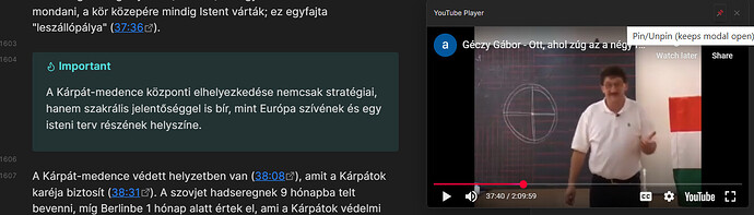

You can pin the window to keep it in view and close it with the ‘x’. You can drag the window around pressing on the top of the modal.

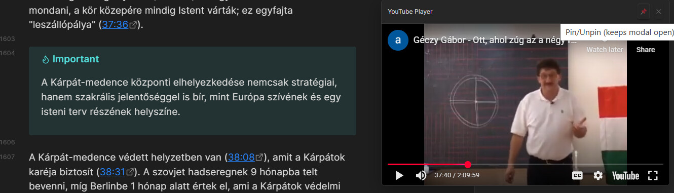

Screenshot of modal not pinned yet:

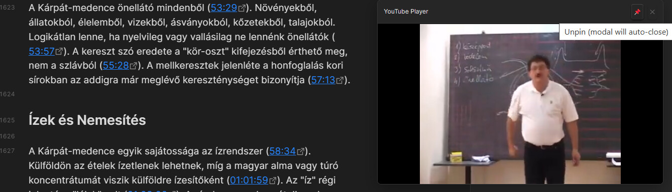

Then after pinning:
Now you can add some comments to your AI summary, or take some screenshots, whatever.
