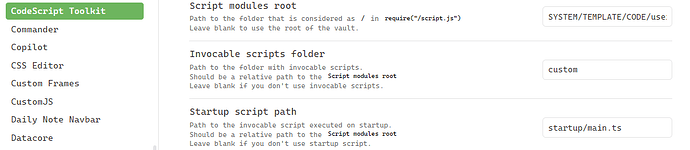

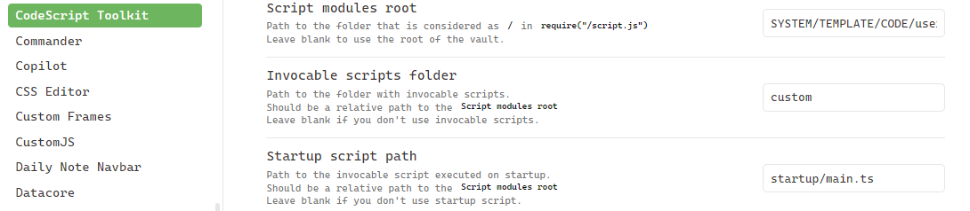

We will be using the CodeScript Toolkit plugin by @mnaoumov.

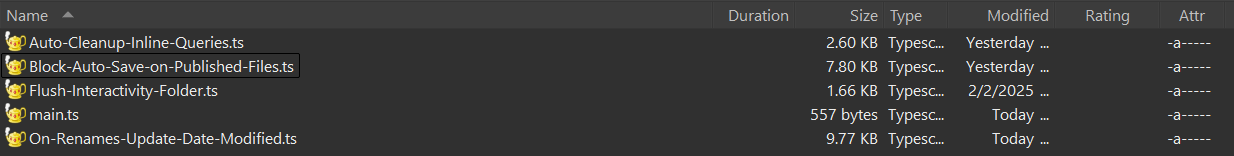

:open_file_folder: Save the script as Block-Auto-Save-on-Files-in-Reading-Mode.ts in the start-up folder given in the settings of Codescript Toolkit.
Add these lines to a main.js file in the same folder:
import { invoke as blockAutoSave } from './Block-Auto-Save-on-Files-in-Reading-Mode.ts';
export async function invoke(app: App): Promise<void> {
  await blockAutoSave(app);
It is important you add these files in startup folder so the plugin loads it.
In my case, it looks like this (all in one folder, like pigs in one blanket):
