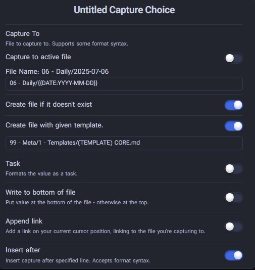

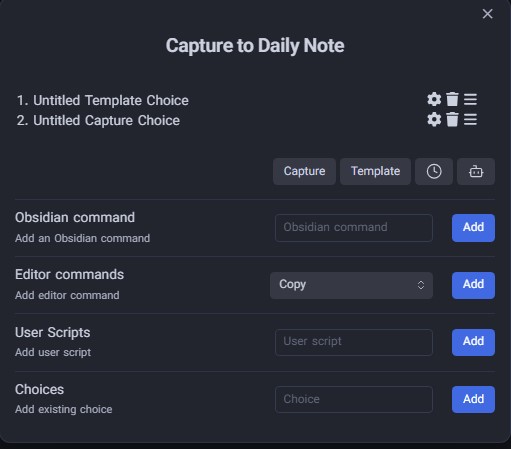

This solution was not provided for Daily Notes, so I also included some screenshots of the macro structure to show the template being applied first, then the capture being applied.

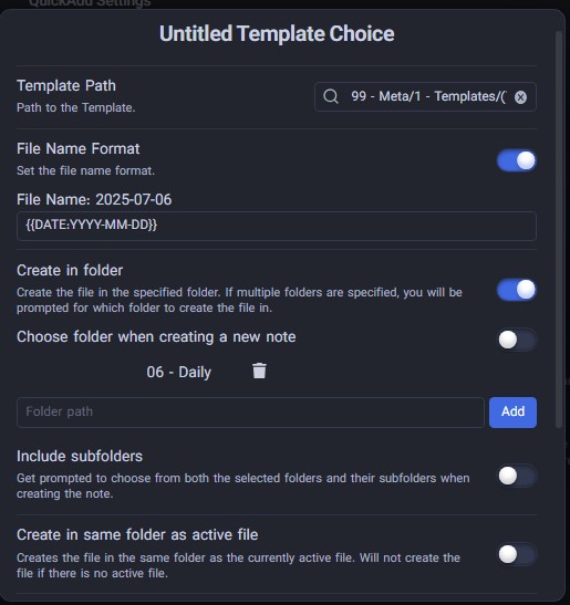

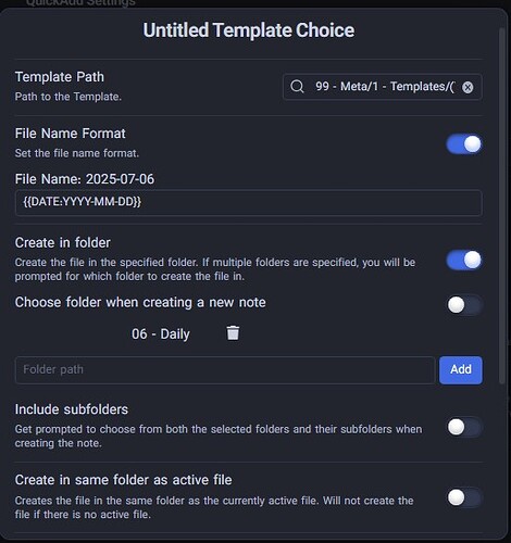

At this point Template path and if you want your file name to be asked from
{{Field: <Field name>}}

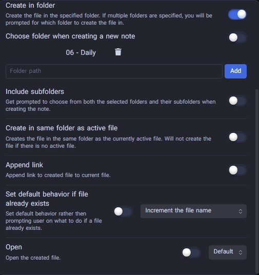

The folder path is also adjustable in the file name section, but I suggest using Folder Path
Here is the Capture Settings section.
Set the folder and half file path as before. (This time, like the image, the folder path and the file name must be adjusted together)
Set the template path as before.

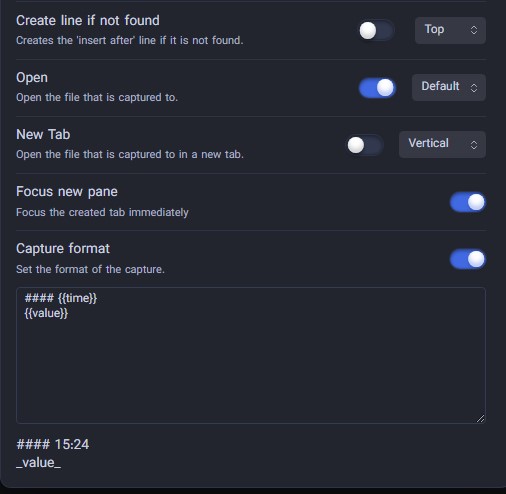

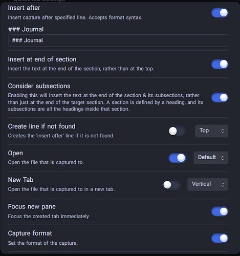

Here are options like Insert After, Open, etc. to change your needs.
In this image, the settings are based on my Daily Note structure. (Maybe give you ideas)
