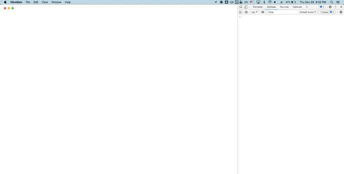

Launch Obsidian. The main window appears but it’s totally blank. Worked fine until about a week ago. Nothing changed that I know of.
I can’t access any settings, etc. So not able to perform the troubleshooting steps.
The Obsidian window to appear with typical content/menu items, etc.
Just one window that is totally blank
Cmd-P doesn’t do anything so I can’t get debug info

There aren’t any error messages in the console.log
