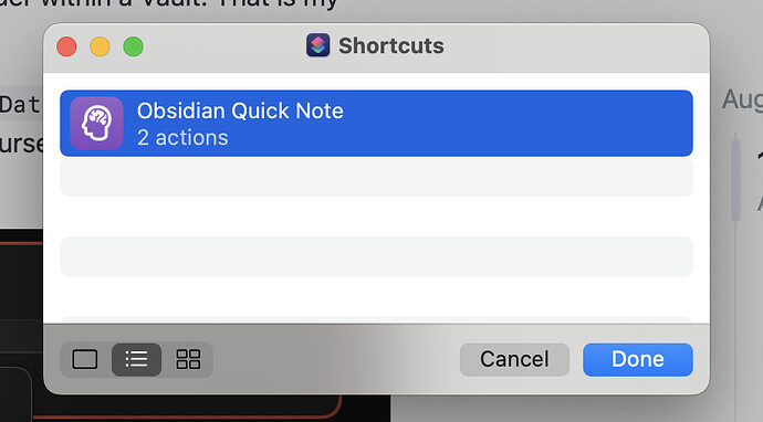

The change here is that I’ve created an “Inbox” - it’s a folder within a Vault. That is my ‘dumping’ location for notes that need a quick capture.
Then in File Path, if you right click, you can get Current Date as an option. If you set it to custom, you can use unicode standards. I like mine, of course, with yMMdhhmm as that will give a straight number that stays in order.

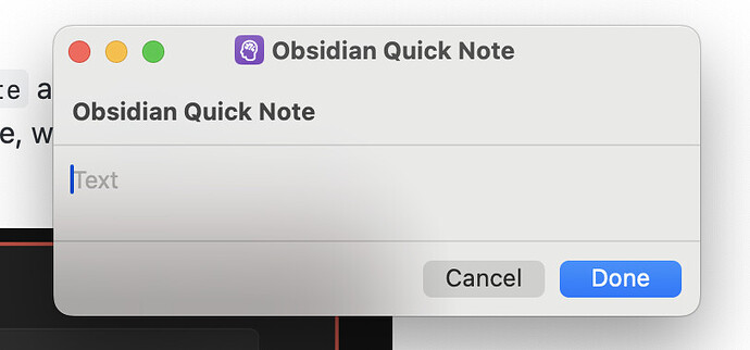

Hi there @matchavez, this is awesome!! I downloaded this version and ran it in Shortcuts to test and it works! I set it to my pre-existing inbox folder and customized the date and it works then too. When I run it in Shortcuts, it prompts me for text, and creates the note in the right spot. Magical.
