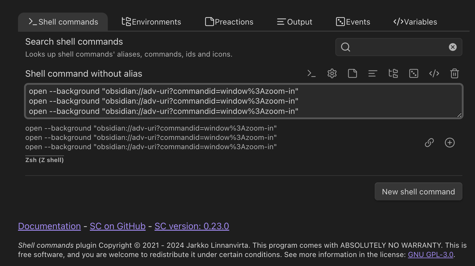

I did manage to work around this issue Setting Zoom at startup
Here is an elegant work-around by @blue_emperor
