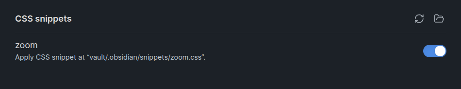

Also don’t forget to enable the new zoom.css file at the bottom of Settings->Appearance

Go to Settings->Appearance and enable your new CSS file:
Now changes to --custom_zoom immediately affect your running obsidian instance and are persisted between restarts.
