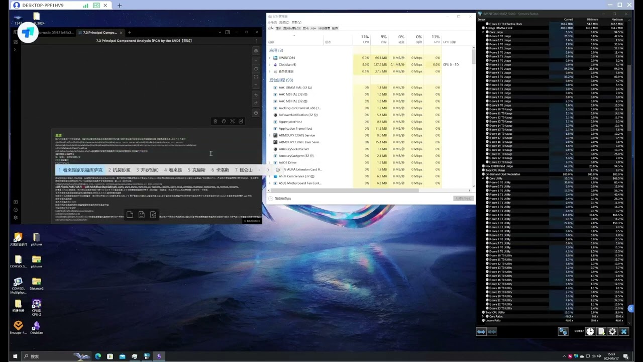

I have tested the 13900K+3090, 7950x+4090, and 7950x3d+4090, and there is a serious issue with Canvas performance. No configuration can smoothly run a Canvas card with 26,000 characters of content
In this post,For heavy Canvas users (from hundreds of thousands to millions of words), which computer components should be upgraded?
I have described the problems I encountered and tried some methods, but none improved the situation. So, I thought about testing using a remote computer rented online.
Why the coherence of the cards and side-by-side display is so important, and why I think a two-dimensional note like Canvas is more important than Markdown. To gain inspiration by displaying information and its relevance within a limited space.

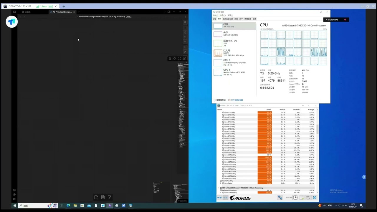

Platforms:
  • 7950X
    • Configuration:
      • CPU: 7950X
      • Memory: Kingbank DDR5-6000 64GB (shows 4800Mhz on Windows)
      • Graphics Card: RTX 4090
      • System: Win10
    • Benchmarks:
    • PS: Remote desktop + Task Manager + HWinfo64. The first time using OSB to record, the window selection was wrong, and the recording was not successful.

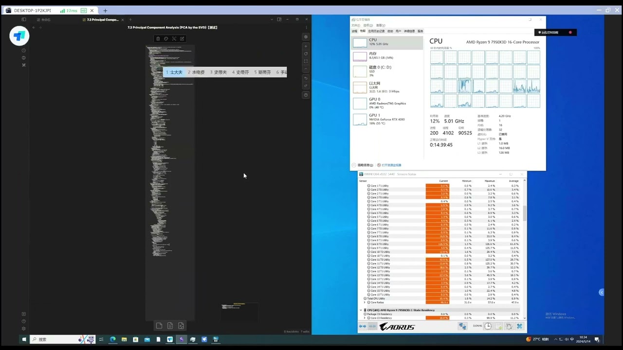

  • 7950X3D
    • Configuration:
      • CPU: 7950X3D
      • Memory: Kingbank DDR5-6800 64GB (shows 3600Mhz on Windows)
      • System: Win10
    • Benchmarks:

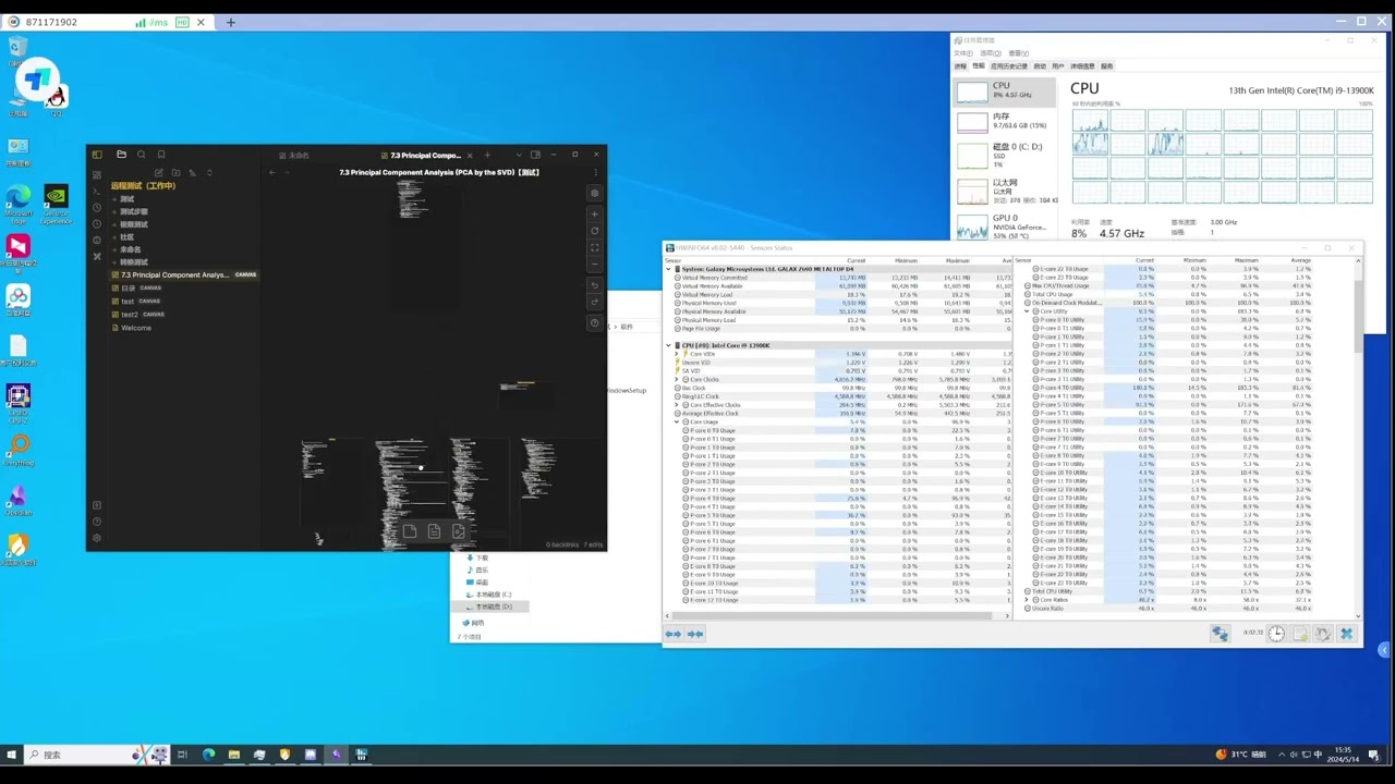

  • 13900K
Testing methods:
  • With plugins enabled and disabled
    • Single-core test: Input into a card in Chinese, English, and LaTeX. Observe Core Usage in Task Manager and HWinfo.
    • Multi-core test: Use the right mouse button to move the Canvas, loading multiple cards to test multi-core (only two threads working).
Test results:
  • 7950X+4090+DDR5 4800
    • Due to the first test, the recording was not successful, and the testing method was not well planned (plugins were not disabled).
    • Conclusion:
      • Editing a 27,000-character card causes noticeable input lag, with Chinese < English < LaTeX.
      • Dragging the page is laggy.

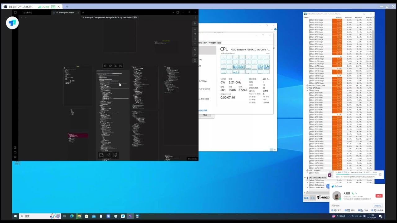

  • 7950X3D+4090+DDR5 3600
    • With plugins enabled:
    • With plugins disabled:

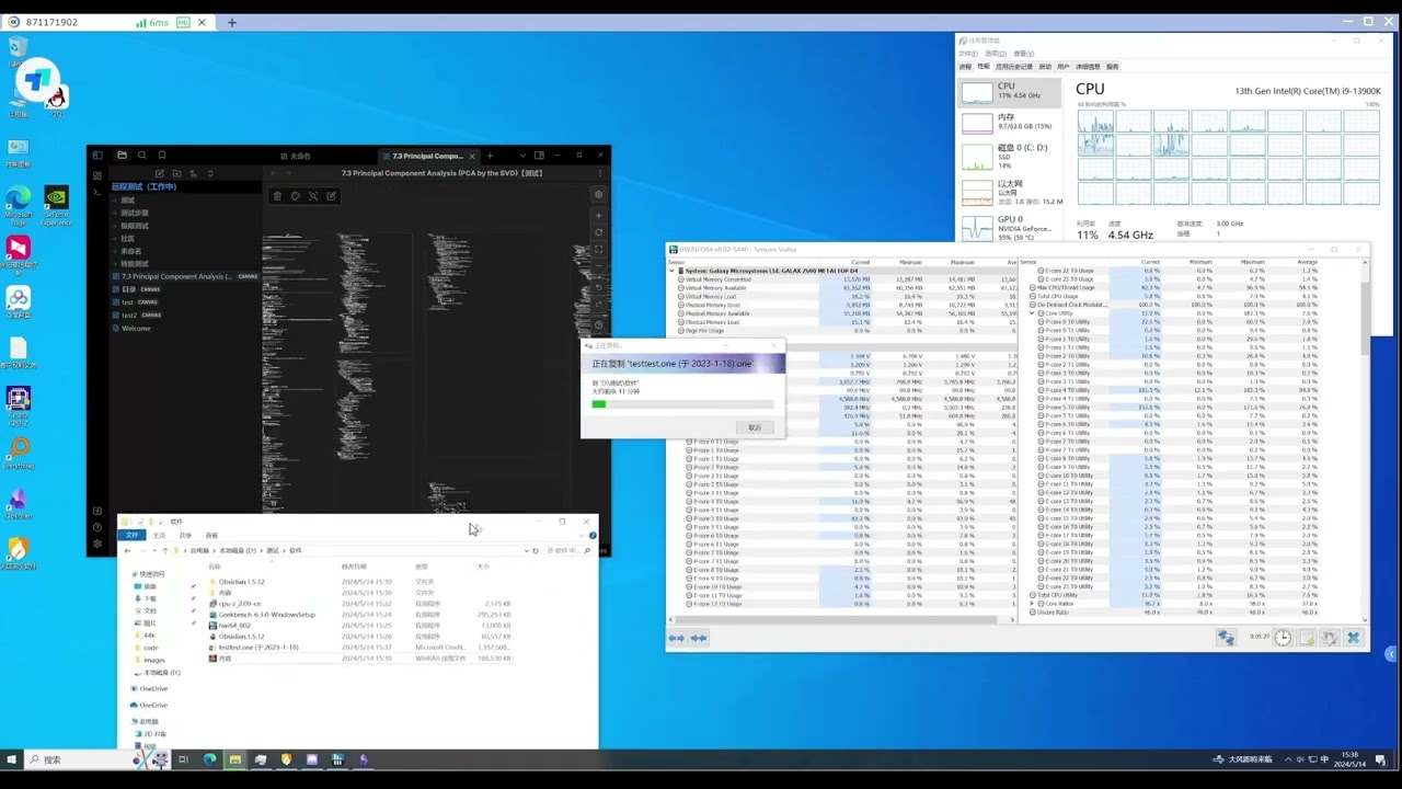

  • 13900K+3090+DDR4 3200
      • Dragging the page, two cores reach a usage of 116.4%, 115.8%, the lag is perceptibly the same as the 7950X3D.
      • Inputting content, one core reaches a usage of 158.4, slightly better than the 7950X3D.
      • Dragging the page, two cores reach a usage of 110.1%, 154.4%, the lag is the same.
      • Inputting content, everything but LaTeX is good.
Conclusion:
  • Which hardware improves Canvas performance:
    • Graphics Card (almost no improvement, my test platforms were all 4090, 3090)
    • Memory (did not feel an improvement)
    • CPU, single-core performance or single-thread performance (very important)
  • Test results:
    • Canvas has almost no multi-core optimization, at most two cores work.
    • The graphics card hardly works. During dragging and writing content, the graphics card does not work (because I used a remote desktop, so the graphics card usage is mainly due to the remote desktop software). On my own computer, the 3060 hardly works.
    • The main reason for Canvas lag is the CPU single-core usage exceeding 100%.
    • The same number of characters in a markdown document does not cause lag, but it does on a Canvas page, suggesting that markdown has block content rendering, and Canvas has serious optimization issues.
    • Plugins affect the smooth experience of Canvas, especially Latex-suite 1.7.4 (because we need to automatically enter & under $$ with tab, so we updated to the latest), even if you do not edit LaTeX content, it will cause lag with 26,000 characters (the main reason, disabling plugins can edit smoothly)
    • There is not much difference between AMD and Intel, at least at the user perception level, X3D does not improve.
    • It may be related to memory
      • When I used the 5800x, the CPU was not fully loaded when dragging, but when I used the 13900 with 2400 memory, the single core was still full, that is, it exceeded 100% in HWinfo64.
Suggestions:
  • Add hardware acceleration features, don’t let the graphics card idle, let it help with the rendering and editing of markdown.
  • Add multi-threading support
    • First, allocate different threads to multiple cards to improve multi-core utilization.
    • Second, support partitioning of individual cards to reduce the burden on a single core.
  • Optimize LaTeX, whether plugins are enabled or disabled, inputting LaTeX causes severe lag.
  • Convert cards into markdown documents.
    • Due to limited rental time, I did not test whether Markdown cards in Canvas would perform better. I will upload the video after I have edited it.
Update Content - Video

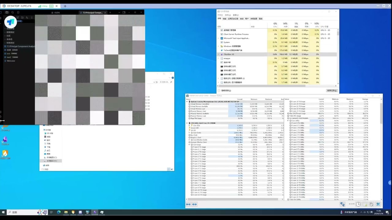

    • With plugin enabled dragging
  • With plugin enabled inputting
  • With plugin disabled dragging
  • With plugin disabled inputting
    • With plugin enabled dragging and inputting

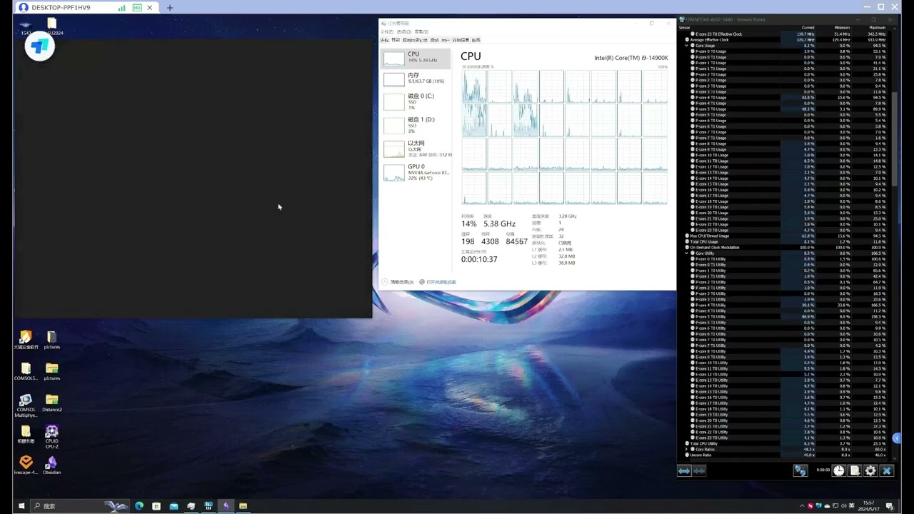

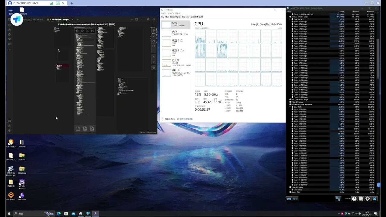

Test Platform:
  • 14900K+4090+DDR5 6000
  • Benchmark Scores:
    • CPU-Z
      • Single-core: 915
      • Multi-core: 16677.3
    • Geekbench
      • ASUS System Product Name - Geekbench
Videos:
  • Video 1: Drag-and-drop and input performance test with plugins enabled and disabled under snippet.
  • Video 2: Drag-and-drop and input performance test with plugins enabled under disabled snippet.
  • Video 3: Drag-and-drop and input performance test with plugins disabled under disabled snippet.

Update Performance Report, Drag Behavior Report, and Input Behavior Report.
Enable pulg-ins
inputting.part01.zip (3 MB)
inputting.part02.zip (2.5 MB)
dragging.part01.zip (3 MB)
dragging.part02.zip (1.1 MB)
disable plug-ins
disalbe-dragging.zip (1.5 MB)
disable-inputting.part01.zip (3 MB)
disable-inputting.part02.zip (3 MB)
disable-inputting.part03.zip (131.7 KB)
Obsidian version: v1.6.7
Installer version: v1.6.7
Operating system: Windows 10 Enterprise 10.0.19045
Community theme: Blue Topaz v2023111501
Snippets enabled: 6
Plugins installed: 55
Plugins enabled: 26

Ok, I am gonna move this to the help section, as performance problems are not bugs per se. You can open a Feature Request asking to improve the performance on large canvas.
Two things I noticed in your screen recording.
  1. you keep multiple long notes completely unrolled in view. That’s really taxing.
  2. It doesn’t look like you you using the “Zoom threshold for hiding card content” optimization at all.
We are aware that there is a bug when panning in and out in a region where there is a large number of nodes and that is going to be addressed.
Thank you for your reply. Over the past few days, I have tested a few things and found the following:
  1. Reinstalling Obsidian can bring some performance improvements (while also deleting AppData\Local\Programs\obsidian and AppData\Roaming\obsidian). However, in my previous tests on a remote computer, I only copied the vault, and the situation remained the same. I guess the new version might have updated some performance features?
  2. Assigning Obsidian to the integrated graphics, for example, through the graphics settings page (the one that allows using hardware-accelerated GPU scheduling), and assigning Obsidian to the integrated graphics. These two methods do not significantly improve the canvas but greatly optimize markdown editing. The former makes writing smoother, and the latter prevents freezing when quickly scrolling through markdown notes. Actually, I am also puzzled why my 3060 freezes, but the integrated graphics perform very well. It might be due to bandwidth or other reasons? I have tried completely reinstalling the drivers, but it didn’t help much.
As for why I don’t use the “Zoom threshold for hiding card content,” it’s because I need these cards to be displayed to facilitate my thinking and separately record ideas. This is also why I have always advocated for using canvas for two-dimensional nonlinear note-taking.
