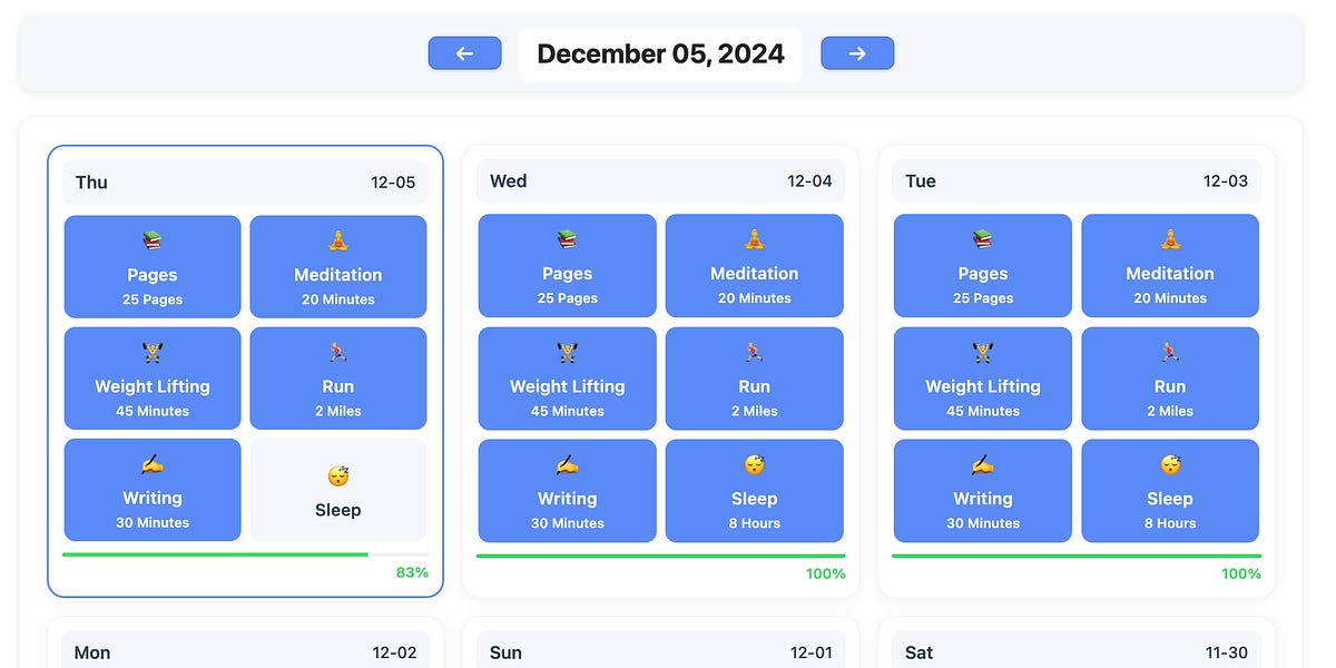

Hey Everyone, Stole so much from these forums over the years of using Obsidian and I wanted to give back.
I made a fully interactive and powerful habit tracker that uses analytics, trends, as well as a user friendly UI to help add some pizazz to our notes. check out the sample vault and article detailing how it works and how to customize it here:

First of all, thanks for this fantastic piece of work leveraging yet more Datacore!
The following is just some advice for people who want to use your script:
Stylistic changes
1
I was fiddling around with it and have found that despite modifying the colors as per your guide, the cards remained white.
So I replaced all instances of 'white' in your script with my choice of colour ('#1F1F1F').

The part with const StyledCard = ({ children, extraStyles = {} }) => ( also needed some tweaking as backgroundColor: 'var(--background-primary)' might not be a good fit for all themes.

Hey, really appreciate this. I have one question about “day of the week” shown here.
I have absolutely no idea why it shows Thursday instead of Wednesday for 1/1/2025 and so all of the other date is kind of one day of the week forward if that makes sense.
We don’t see what else you have changed in the script apart from the property ‘Hangboard training’.
Did you change anything in these lines:
const DAYS = ['Sun', 'Mon', 'Tue', 'Wed', 'Thu', 'Fri', 'Sat'];
          {DAYS[date.weekday % 7]}
I’m not sure how OP’s script handles system locales – I mean what OS or Obsidian locale settings end users need for alignment in the script. There may or may not be additional friction for users. What I can see is OP used the first day of the week as Sunday.
One may want to change the name of the day to one’s own language and which day the week starts.
Apparently, there are two ways to do this:
1
Set the days of the week array manually, starting with the preffered day of the week, in your own language (I am giving abbreviations of English days here now):
const DAYS = ['Mon', 'Tue', 'Wed', 'Thu', 'Fri', 'Sat', 'Sun'];
As for the other line, exchange
with:
          {DAYS[date.weekday - 1]}
  • Use the DAYS array to get the day of the week.
2
  • Remove (or comment out with // ) the const DAYS line. That is no longer needed. I like to apply the commenting out method to see what method was used there before.
  • Exchange the following line
with:
          {date.toFormat('cccc', { locale: 'en-US' })}
  • Use Luxon’s toFormat method to get the day of the week.
    • Get the locale code for your own country. Mine is not USA.
    • Again, I kept indentation levels intact, as you can see.
I think this second method is more straightforward and will remove friction for any users from any locales.

Ah yes, I did change
into
after changing it back to the original, it seems to work normally but I can’t figure out why. I suppose this has to do with date.weekday default starts from ‘Sunday’ instead of ‘Monday’

Also, after 3 months of usage, I managed to figure out and fix the habit trend in the monthly metric card with the help of DeepSeek.
The problem: the way to calculate trend in the current code is (current-previous)/previous. While the current period spans the correct range, the previous period is wrong. The original code makes it so that the previous period covers only exactly 1 month ago today to end of that month.
Original code
  const previousMonthNotes = dc.useMemo(() =>
    sortedNotes.filter(note => {
      const noteDate = dc.luxon.DateTime.fromISO(note.$name);
      const monthAgo = selectedDate.minus({ months: 1 });
      return noteDate >= monthAgo && noteDate < selectedDate.startOf('month');
    [sortedNotes, selectedDate]
Eg: This logic will include notes from a 30-day period before the selectedDate, which might span parts of two months (e.g., if selectedDate is October 15th, monthAgo would be September 15th, and the filter would include notes from September 15th to September 30th).
Revised code (thanks to DeepSeek)
const previousMonthNotes = dc.useMemo(() => {
  const previousMonthStart = selectedDate.minus({ months: 1 }).startOf('month');
  const previousMonthEnd = selectedDate.minus({ months: 1 }).endOf('month');
  return sortedNotes.filter(note => {
    return noteDate >= previousMonthStart && noteDate <= previousMonthEnd;
}, [sortedNotes, selectedDate]);
