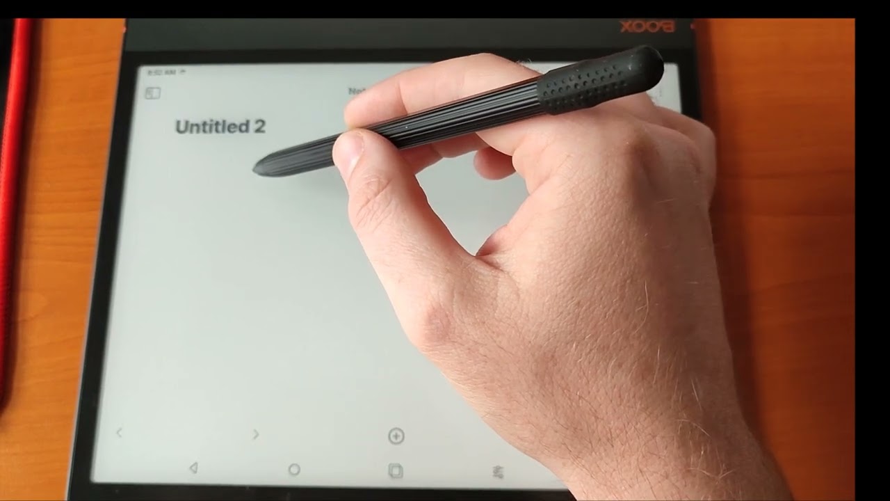

I cannot type, because the keyboard disappears after a brief moment. I tried reinstalling the app, now I cannot even log in, because I am unable to put in my credentials. It was working perfectly before the firmware update. The same thing happens with every keyboard app, but only in Obsidian. Both the app and the device is up to date. I tried reinstalling the app, but the issue persists. (I also lost access to sync because I cannot log in, as I am unable to put in my credentials.)

The issue on video:

From your video, it looks like that the Boox keyboard is “stealing focus” from Obsidian, hence the cursor is removed and keyboard disappears.
I half understand what you’re saying now, thanks. It’s not my video, but it could be: the issue is identical. It’s not just the BOOX keyboard, it’s any keyboard on the device. So it doesn’t work with Gboard, for example.
