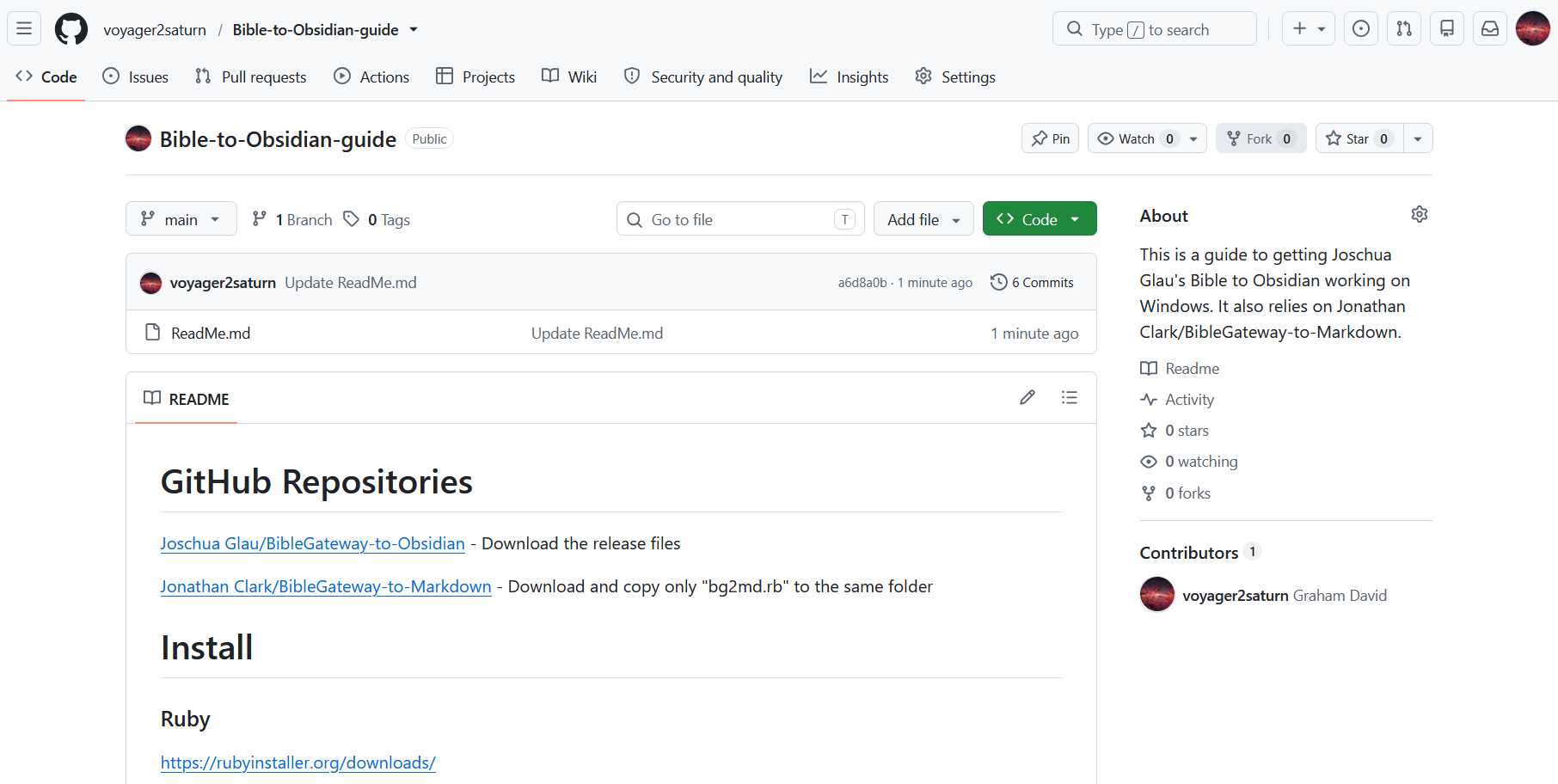

Created a guide for Windows in my github page
voyager2saturn/Bible-to-Obsidian-guide
