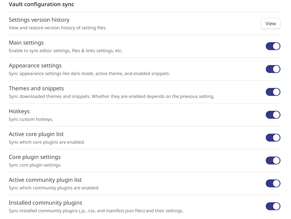

On both devices, I am syncing to the same obsidian vault with no excluded folders. In the Selective Sync settings, I have “Sync images” and “Sync audio” selected. I have everything under “Vault configuration sync” turned on:

With Obsidian Sync you have options, per-device, on what you want synced or not. I would suggest using the same .obsidian config folder on both devices, but adjusting the Vault configuration sync (your screenshot above) toggles for what you want synced or not between your PC and Android device.
I’d make a backup of .obsidian on your PC (just to be safe), set the toggles of what settings you want synced, and close/open the vault. You can verify what settings are uploaded to your remote vault by looking for .json files being uploaded after you make a settings change.
Then on the Android device, set the config folder back to .obsidian, adjust the Vault configuration sync toggles as needed, and restart. I haven’t changed config folders in a while, so I’m not sure if when you change it to .obsidian from something else, if the Vault configuration sync toggles will be all off (the default) or whatever you have currently set. You’ll have to experiment a bit.

One misconception I think I had is that I needed to have the same Vault configuration sync toggles on both devices for consistency and so that per-device settings could get synced to the vault. But, no, actually I have to turn off the most of the toggles on the phone for it to have its own settings. So for now I have kept only the first three toggles on my phone.
And initial setup of Obsidian sync is different, right? Because in the beginning I want to sync every plugin and setting I might want and then turn off the ones I don’t want, so I am not setting up plugins one by one all over again on the mobile device. So the right workflow seems to be: Turn on most of the toggles when first setting up Obsidian sync, let it sync, then turn most of them off on the mobile device. Am I on the right track?

As all the Vault configuration sync toggles are off by default, I would only turn on the sections I want to sync and then set those same settings on the other device(s).
