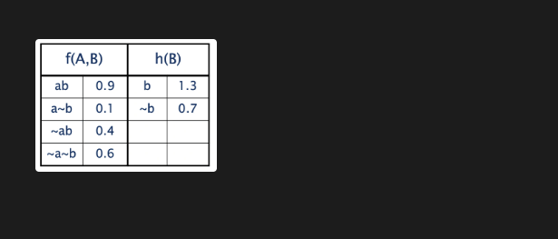

No, it does not insert a tab. The image needs to be in focus/selected and then you do g<Enter> or <tab>.
Obsidian_POqZNRZC3h
Let me add because I starting to wonder if this other part is not clear, enter is used to to quickly edit the filename part, tab is used to edit the size part.

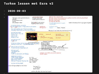

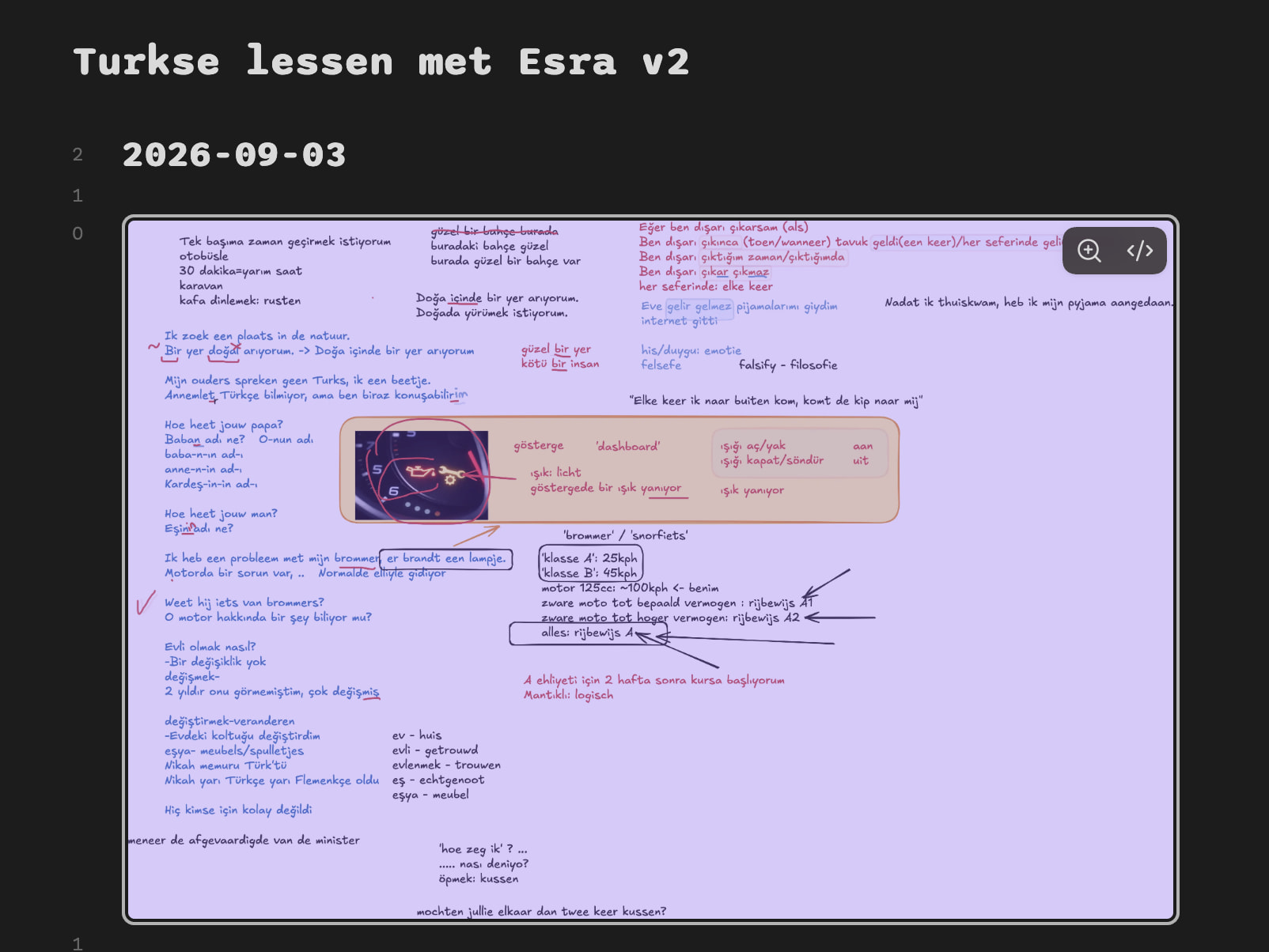

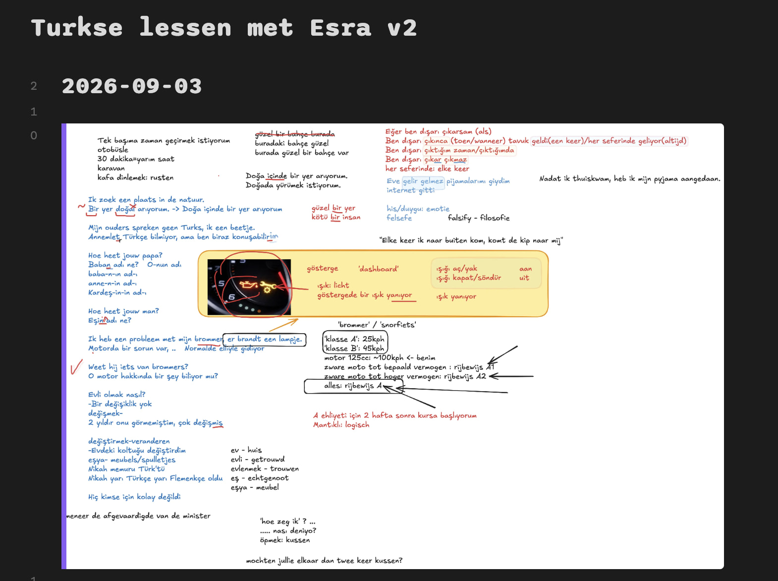

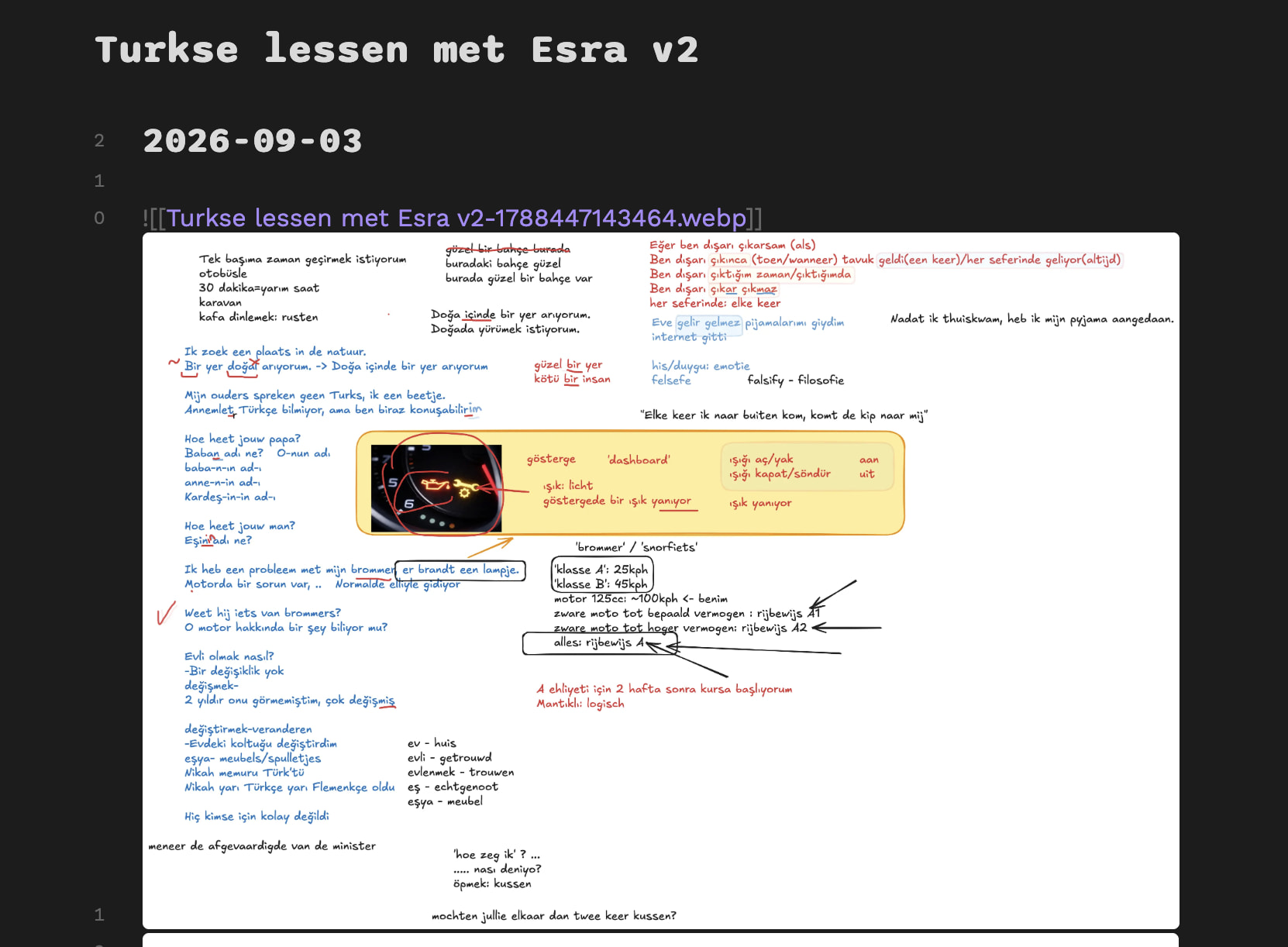

For me, Tab does the trick, but I need to have the image highlighted.
So going to the line with the image, and then one l to highlight it, and then hitting Tab.
  1. selecting the line
  1. hit l
  1. hit Tab
Now I can edit without switching to source mode or doing any vimrc tweaks.
