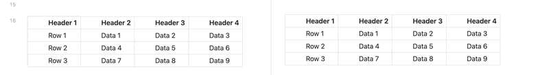

I also discovered that the Minimal theme does weird things to table borders and doesn’t appear to respect settings in the Style Settings plugin. That’s odd, as it seems to be a popular and uber-configurable theme. Regardless, when I use it, all my cell borders except for the header row disappear, and if I switch back to the Default theme, they come back. Not sure what’s up with that.

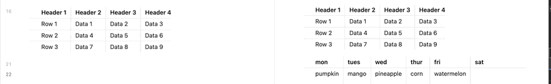

The snippet I shared above appears to be working with Markdown tables in Minimal:

Minimal has a lot of settings (both in Minimal Theme Settings and Style Settings). It’s easy to get lost, even with search.
For the table borders, the Cell lines toggle seems the one you want.
CleanShot 2025-07-27 at 09.27.59
Is that setting not working on your end?

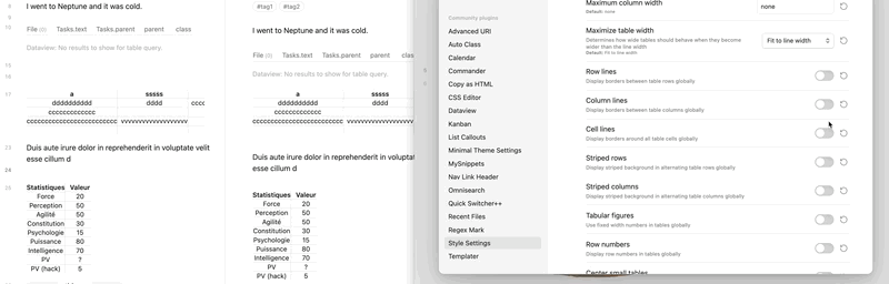

Thanks—I see the settings now. Not sure how I missed them before. Maybe it was stress brain. I noticed that when I turn on row and column lines, there is no padding, but if I turn on cell lines, Minimal does insert padding. That’s what I was going for all along.
I’m familiar with the Style Settings plugin but not Minimal Theme Settings—where does that live? Are you referring to the Appearance tab in Obsidian settings?
It’s a separate plugin available in the community gallery; search and install the same way as you did for Style Settings.

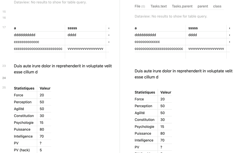

I can adjust nearly any CSS property, but padding: 2em; doesn’t touch the left padding of the first column. I’m guessing the first column is a special case.
Using the default theme the above should be fine. Here I’m changing padding-left from 3em to 0.

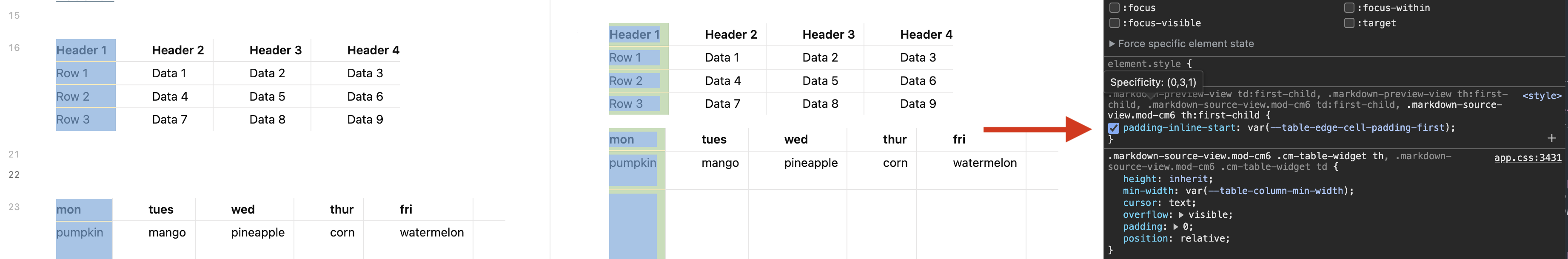

CleanShot 2025-07-31 at 08.13.16
This is where using the dev tools inspector comes in handy. It appears Minimal has some other CSS that’s overriding that (editor selector pictured):
.markdown-source-view.mod-cm6 th:first-child {
    padding-inline-start: var(--table-edge-cell-padding-first);
with --table-edge-cell-padding-first set to 0. There may be more, but some custom variables/properties for tables from Minimal:
  --table-header-border-width: 0;
  --table-column-first-border-width: 0;
  --table-column-last-border-width: 0;
  --table-row-last-border-width: 0;
  --table-edge-cell-padding-first: 0;
  --table-edge-cell-padding-last: 0;
  --table-cell-padding: 4px 10px;
  --table-header-size: var(--table-text-size);
So when using Minimal you could use:
body {
    --table-edge-cell-padding-first: 2em;
in addition to other CSS.
