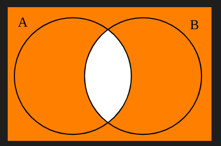

SVG: Pasting SVG / HTML code directly into the markdown note causes it to be incorrectly rendered in reading mode
This only happens with some SVGs. I’ll provide one that triggers the bug below.
  1. Open a new obsidian note.
  2. Paste in an SVG that triggers the bug.
  3. Observe that in edit mode the output is correct
  4. Observe that in reading mode the output is different and incorrect.
  5. Paste SVG into an external SVG renderer / html and observe that the output is always correct.

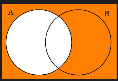

This SVG should be rendered on the page:
In reading mode this SVG is rendered on the page instead:

works for me. post a screen recording of this happening in the sandbox vault
Hello, sorry I didn’t follow up on this yet! Here is a video inside the Sandbox on the latest version of Obsidian:
svg_screen.mp4
I also see it as “incorrect” in Editing mode. And I see nothing in Reading mode. (0.16.3)
screenshot_2022-10-01_12-19-59
Testing another example I found on the web. <clipPath> - SVG: Scalable Vector Graphics | MDN It fails too. It seems in Obsidian (or in CodeMirror, and/or in certain modes in Obsidian) the clip path just isn’t working.

Intended look:
screenshot_2022-10-01_12-53-13
How it shows up in Obsidian:
screenshot_2022-10-01_12-54-13
Curious… I can get it to show up as intended in the Sandbox vault. But in my own vault, with Restricted mode turned on, default theme (dark or light) and no CSS snippets (and restarted Obsidian after turning it all off) it shows up as incorrect.

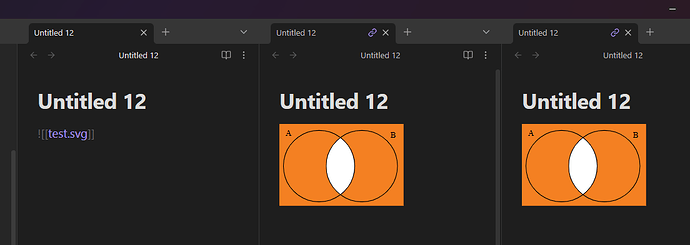

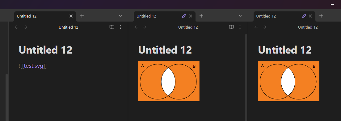

Yes I have noticed that before, if you open it side by side they do not act independently:
double_pane.mp4
It doesn’t work in my sandbox vault, if that makes a difference.

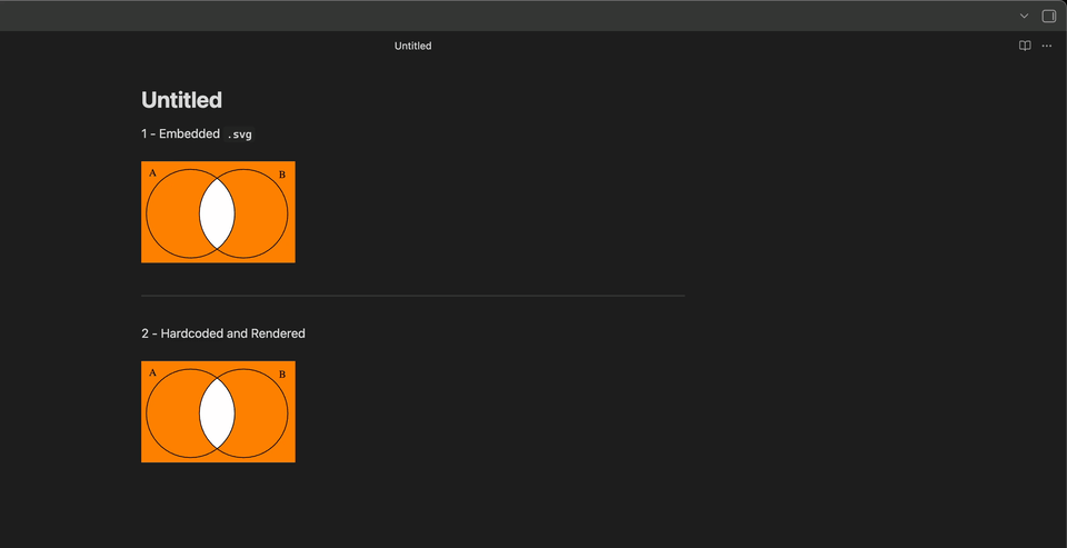

The SVG renders with correct clipping paths in both editing and reading views (screenshot taken in editing view in the sandbox vault):
The SVG renders as follows in reading view:

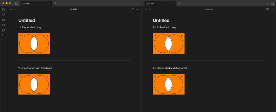

I can repro on Mac (Sequoia 15.6) + Obsidian 1.9.7 in the sandbox vault :blush: …
Although, the results also seems to depend on the svg, how many tabs with the svg are open … and in which view mode the note is in which tab :upside_down_face:
Using the SVG from the post a little bit above, this is what I see when switching from LP to Reading: The embedded SVG renders fine but the written/“hardcoded” one is problematic
SVG 1
Now, if I open the same note in 2 tabs and switch from LP to Source I get some incorrect rendering depending on the tab I select to switch the view :sweat_smile: …
I mean, if I switch from LP to Source in the right tab, the “hardcoded” SVG in the left tab stays as it is… but that’s not the case if I switch from LP to Source in the left tab (in that case, the “hardcoded” svg in the right in LP is incorrectly re-rendered for some reasons :woman_shrugging:
SVG 2
And I get similar results switching from LP to Reading :blush: …
Making the switch on the note in the right tab doesn’t impact how the SVG is rendered in the left tab but making the switch on the note in the left tab impact the rendering of the “hardcoded” SVG in the right tab and the left one :woman_shrugging: …
SVG 3

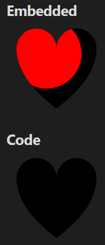

Can confirm the bug seems to go away if it’s embedding a separate SVG file. I was pasting the SVG code directly into the file as text. A quick inspect element seems like the TikZ plugin does an in-place replacement with SVG code, which explains why it’s also bugged. I also fixed up the heart graphic so it actually renders, and I noticed it doesn’t seem to render correctly at all if it’s pasted as code in either mode, but works fine in both if it’s embedded:
No idea what to make of that, it just feels weird.
Fixed heart code:
<svg xmlns="http://www.w3.org/2000/svg" width="200" height="200" viewBox="0 0 100 100">
  <clipPath id="myClip">
    <circle cx="40" cy="35" r="35" />
  </clipPath>
  <path
    id="heart"
    d="M10,30 A20,20,0,0,1,50,30 A20,20,0,0,1,90,30 Q90,60,50,90 Q10,60,10,30 Z" />
  <use clip-path="url(#myClip)" href="#heart" fill="red" />
</svg>
