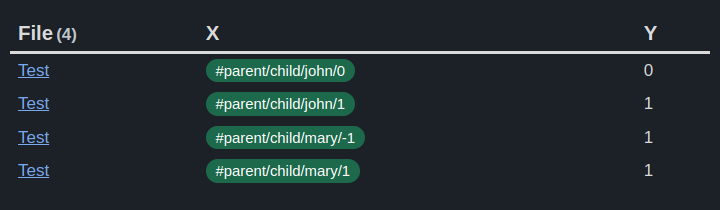

I was able to get the value using the following query.
TABLE X, Y
FROM #test
FLATTEN filter(file.etags, (f) => startswith(f, "#parent/child/")) as X
FLATTEN substring(X, length(X)-1) as Y
Resulting in this

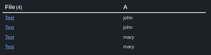

and I was able to get the names using the following query.
TABLE A
FROM #test
FLATTEN regexreplace(regexreplace(filter(file.etags, (f) => startswith(f, "#parent/child/")), "#parent/child/", ""),"/\d+", "") as A
But I can figure out how to merge both, when I try they show empty tables or a lot of rows like above.
