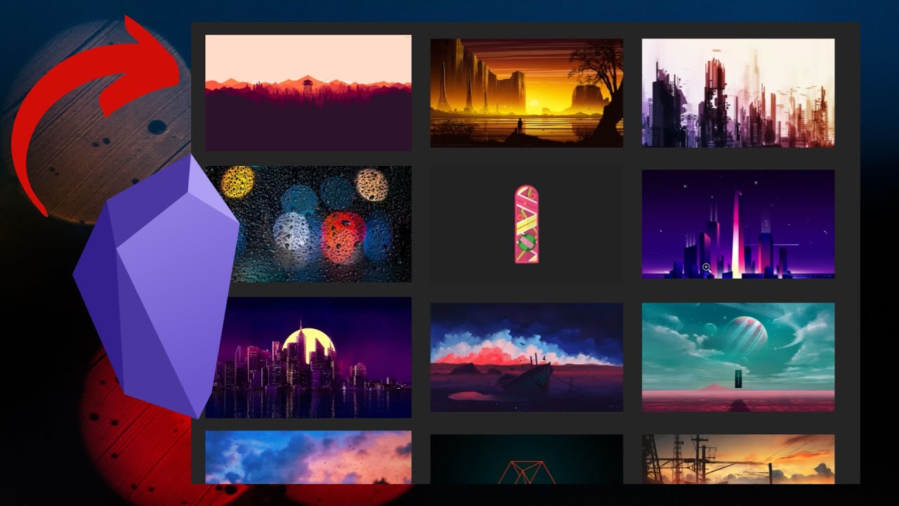

I have an alternative solution that is super simple, and not thoroughly tested. It can be combined with the new cssClass YAML tag to make sure it doesn’t break your other pages templates. In this example I am using cssclass: img-grid to avoid leakage but you can remove that class and apply it everywhere.
See the separate thread I created for this: https://forum.obsidian.md/t/display-side-by-side-image-grid-css-snippet/9359
.img-grid .markdown-preview-section {
    display:flex;
.img-grid .markdown-preview-section > .internal-embed {
    flex:1;
    margin-left:-0.5rem;
    padding:0 0.5rem 0.5rem 0.5rem;
.img-grid .markdown-preview-section > *:not(div) {
    margin-block-start: 0rem;
    margin-block-end: 1rem;
.img-grid .markdown-preview-section hr {
    width:100%;
.img-grid .markdown-preview-section img:not([width]) {
    width:100%;
Then in edit mode simply group your images and the code will automatically create columns.

For anyone wondering the difference with my approach and the one by @kepano Display side by side image grid
The approach I taught in my video tutorial is good for using images together with text in a grid
I’d definetly say use @kepano for image gallery since it’s a lot more elegant and simple.
For anyone one else wondering about how to set it up
The tutorial I made walks through the whole process, all that would need to change is the code used and the name of the img-grid.css instead of the one I used table-border
