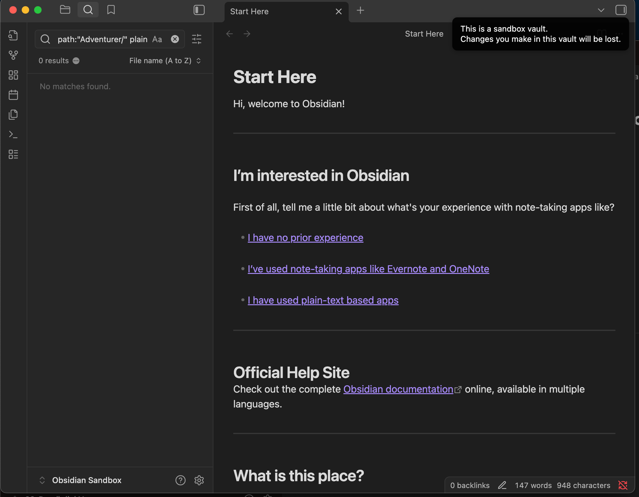

Searching Excluded Folders does not work even when explicitly added to path:
  1. Exclude a folder via the settings.
  2. Click on the folder to search inside it or add it after path: {folder-name}
  3. No results show up
Yes, I tried it in the Sandbox Vault with the “Adventurer” folder
Search results from the excluded folder should show up as per the solution specified here Add Option to search in ignored folders
No results shown

Make it possible to search inside excluded folders when specifically typing its name in
Confirmed in 1.8.10. I thought it might require the whole folder path, but that didn’t help (test query: Path:(2.Caring/22.Home/22.34.Obsidian.Templates) date).

I did some checks and I apparently hallucinated the answer to that thread.
Adding path: never worked. I will create a FR for this
