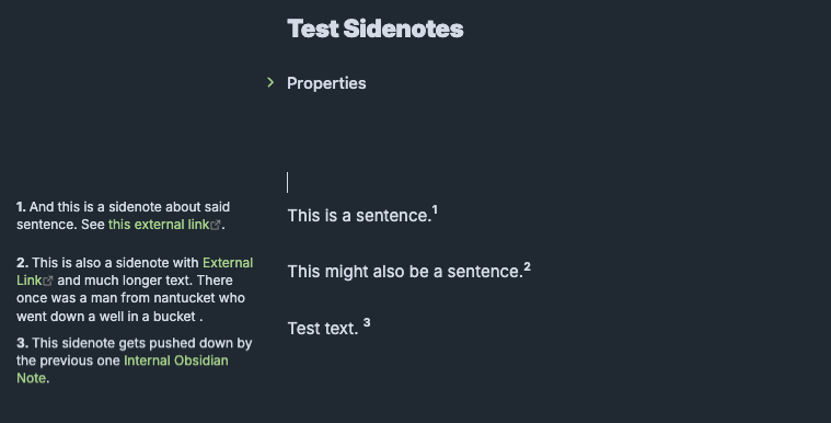

This is a plugin I’ve prototyped in order to solve a problem. I’ve seen multiple strategies for incorporating sidenotes and margin notes. I had cobbled together a CSS snipper that worked pretty well but CSS alone had limitations. The links in the sidenotes were not clickable. I couldn’t quite get incrementing numbers to work. So I put together this plugin to try to solve my problem.
Sidenotes (GitHub)
Features:

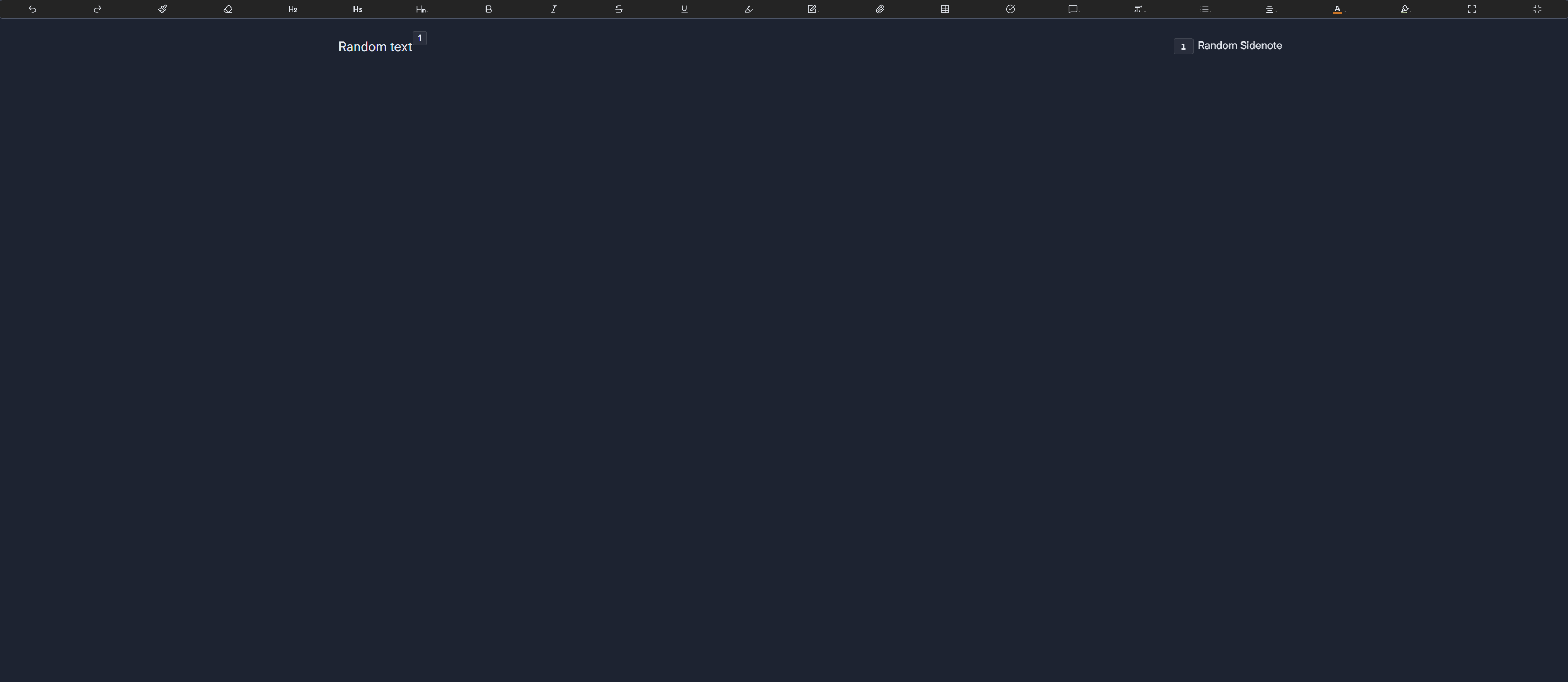

  • Sidenotes: Allows you to write sidenotes which show in the left side margin next to a note’s main body. Because these are meant to show in the margins, one can’t really fully use this in mobile.
  • Customize:
    • Show sidenotes in left or right margin
    • Arabic numbers, Roman, letters, or no numbers
    • Customize spacing to tweak how it takes up space in the margin
    • Customize font size, line height, text alignment
  • Links in sidenotes: The plugin makes sure links in sidenotes appear as links.
  • Superscript numbers can be added to the text. The numbers increment automatically.
  • Dynamic styling: Font size shrinks as horizontal space get smaller. At a certain breakpoint, sidenotes hide when a window gets too skinny.
  • Works in Editing and Reading modes

I tested your plugin and would like to add that it would be great to see the plugin integrated with footnotes in Obsidian directly, as this would make it quite convenient to interact with notes and edit footnote content. If you implemented interaction with footnotes (CSS and so on), this plugin would be indispensable.
P.S. In addition, I miss the ability to click on the location of the sidenotes in the text and edit it “in place” in the area to the right or left, if necessary.
Thanks for the feedback. I understand your suggestion about clicking the location of the sidenote - it’s a good idea but I’ll have to see if I can work out a way to do that.

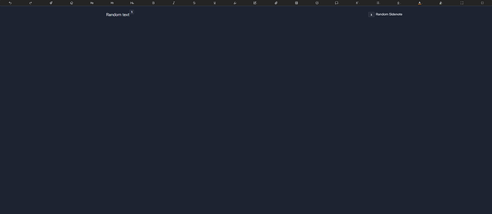

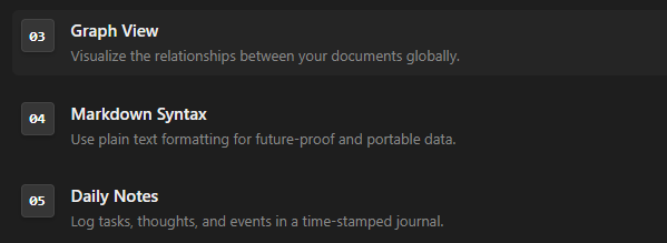

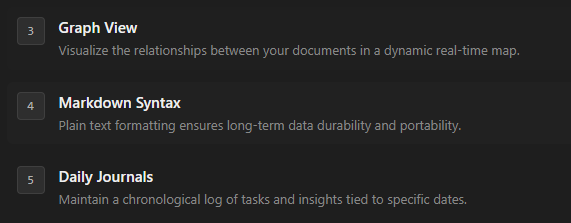

As an addition, it may sound like a question, but is it possible to somehow change the appearance of numbers in the text so that they stand out against the background? Perhaps change their appearance or assign special icons to them, because with a large amount of text, they blend in and are sometimes pretty difficult to recognize (I attached a version of how it might look. As far as I remember, this style of icon is called Neumorphism). You can also try integrating a number of items in the settings that affect color. Text color and number color may seem very important and necessary to some people because they may have different themes and backgrounds. This feature with colors is implemented in Felix’s plugin. Maybe you can get something useful from there.
Also, I noticed that it is not possible to apply bold or italic styles to highlight important points separately. (Markdown style doesn’t work)
Also, when the text is completely deleted from the block during in-place editing and it becomes empty, I am immediately taken to the very beginning of the note.
P.S. Editing notes directly in the margins is fantastic!
I managed to work on the CSS and I think I’ve implemented the number style I mentioned above. I’m attaching the CSS below, maybe you’ll find this idea interesting.
Neumorphism.css (1.9 KB)
Great I’ll work on these:

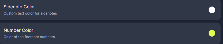

  • an option to customize color to the sidenote numbers.
  • an option for some kind of neumorphism style to make them stand out.

The newest release (0.1.4) incorporates most of your suggestions.
Added:
  • Basic Markdown support (bold, italic, and inline code)
  • 2 new styles for sidenote numbers (neumorphic badge and pill)
  • Option to convert footnotes to sidenotes (Reading Mode Only - a reliable technique for Editing Mode has not been determined yet)

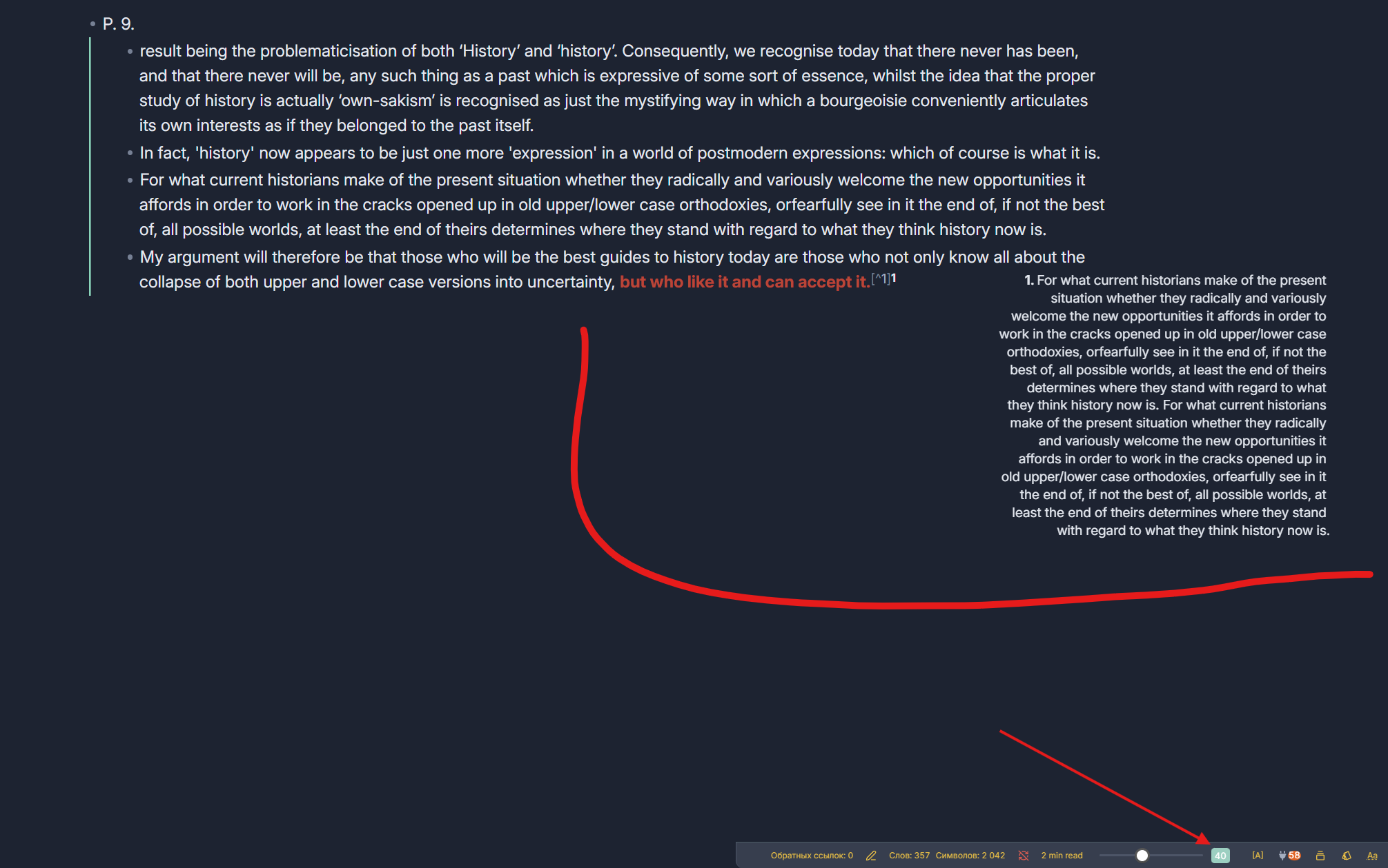

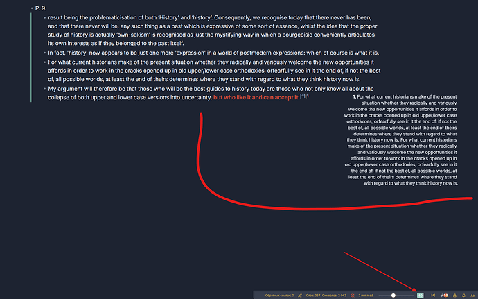

Bug report about version 0.1.4. and suggestions

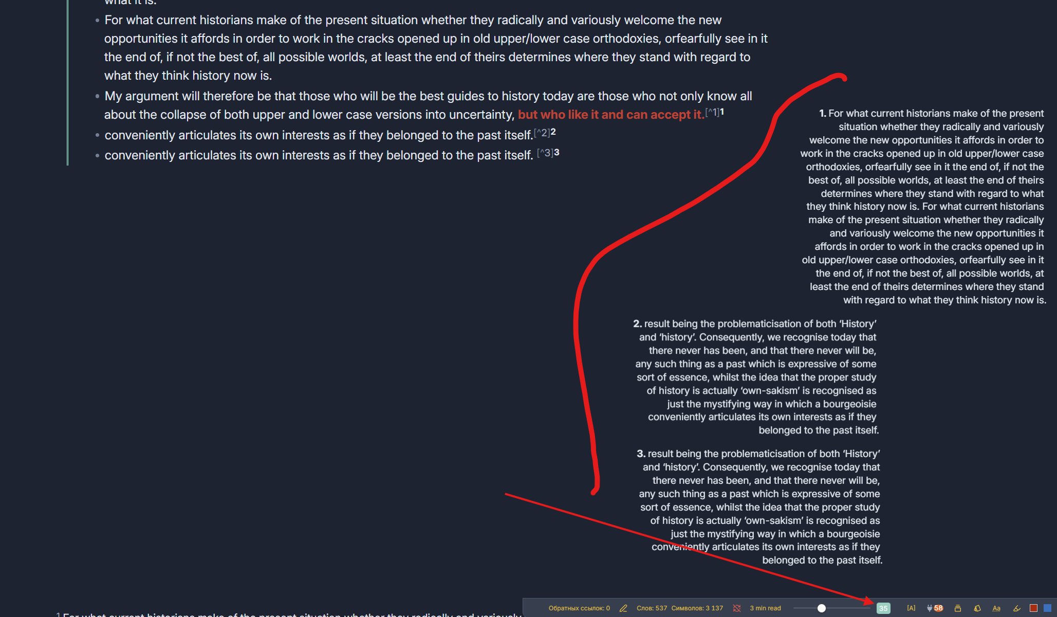

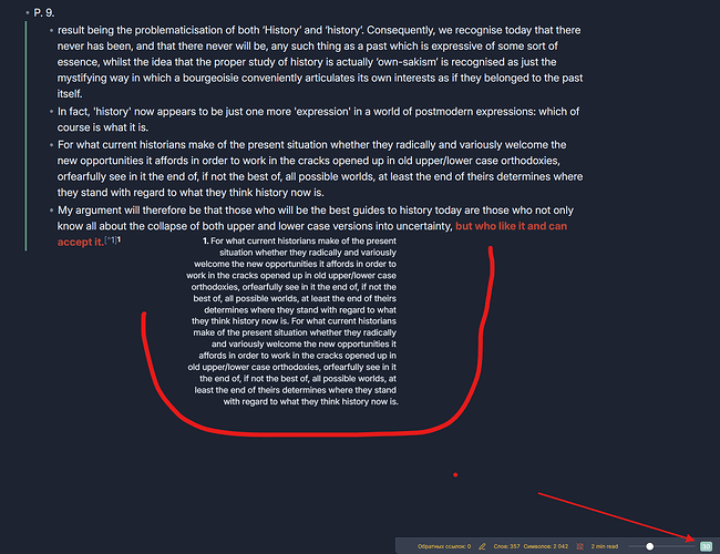

  1. Very small value for gap between sidenote and text. I have a large widescreen monitor and a fairly wide note. The value set at 5 points is significantly insufficient for my case. As a result, the sidenotes overlap the text of the note. This happens with different test values of 30, 40, and 70. As you can see, the text overlaps.

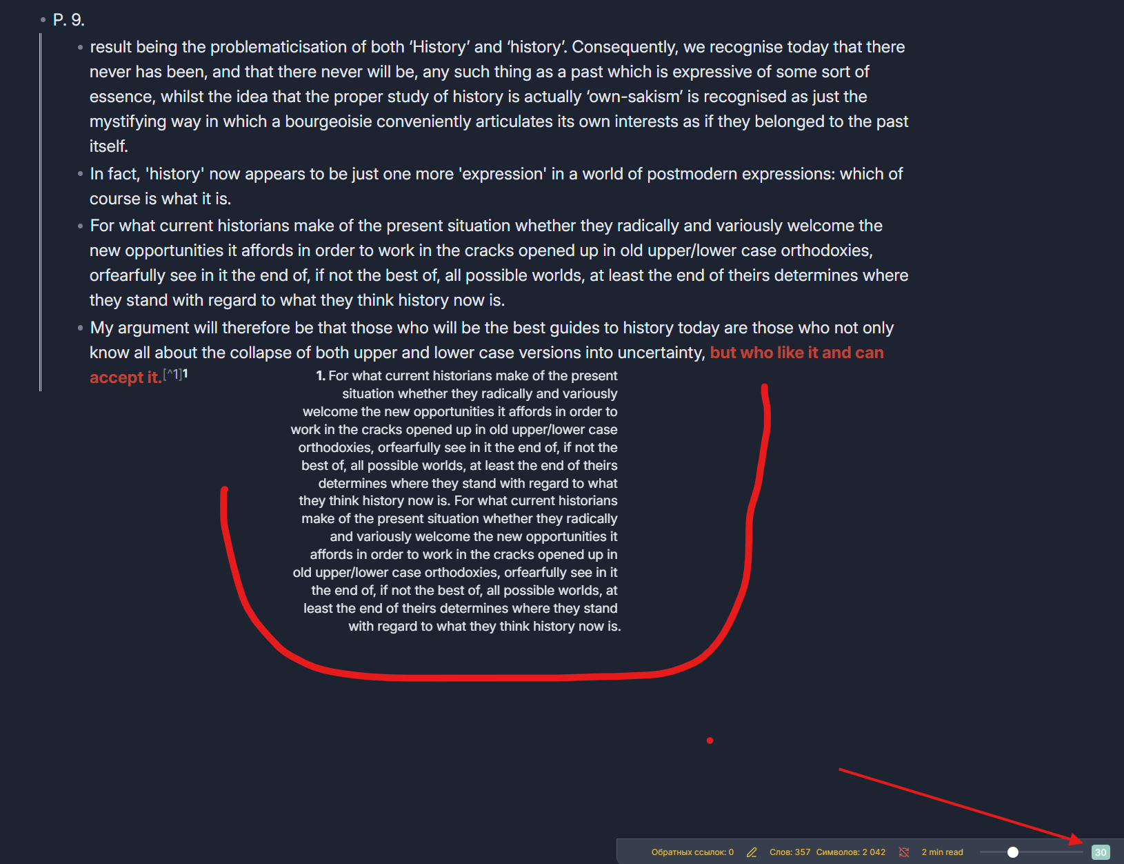

  2. The numbers for the footnote and the block itself are duplicated. In the second screenshot, we can see the number 1 twice, and the same thing happens with other numbers. They are duplicated twice.

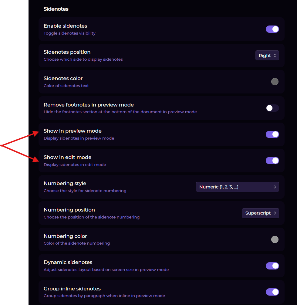

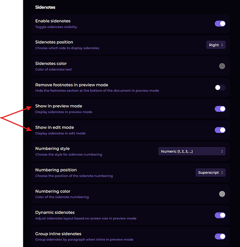

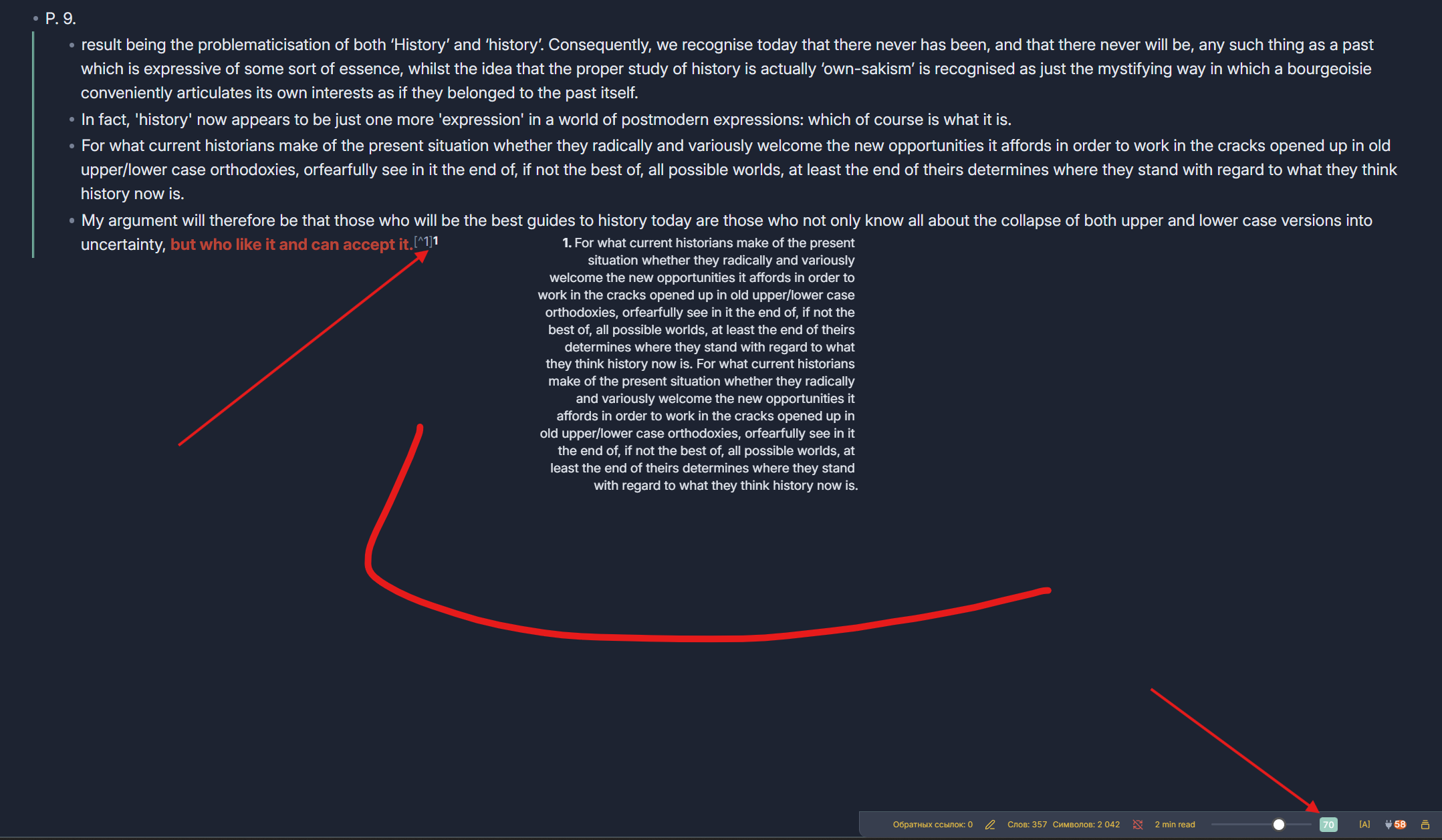

  3. Apparently, you made a mistake, but in edit mode, the footnotes are clearly visible on the side, while in read mode, they are missing.

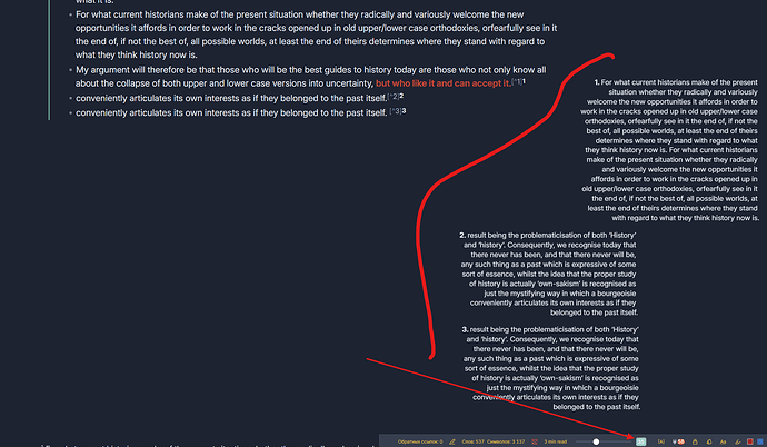

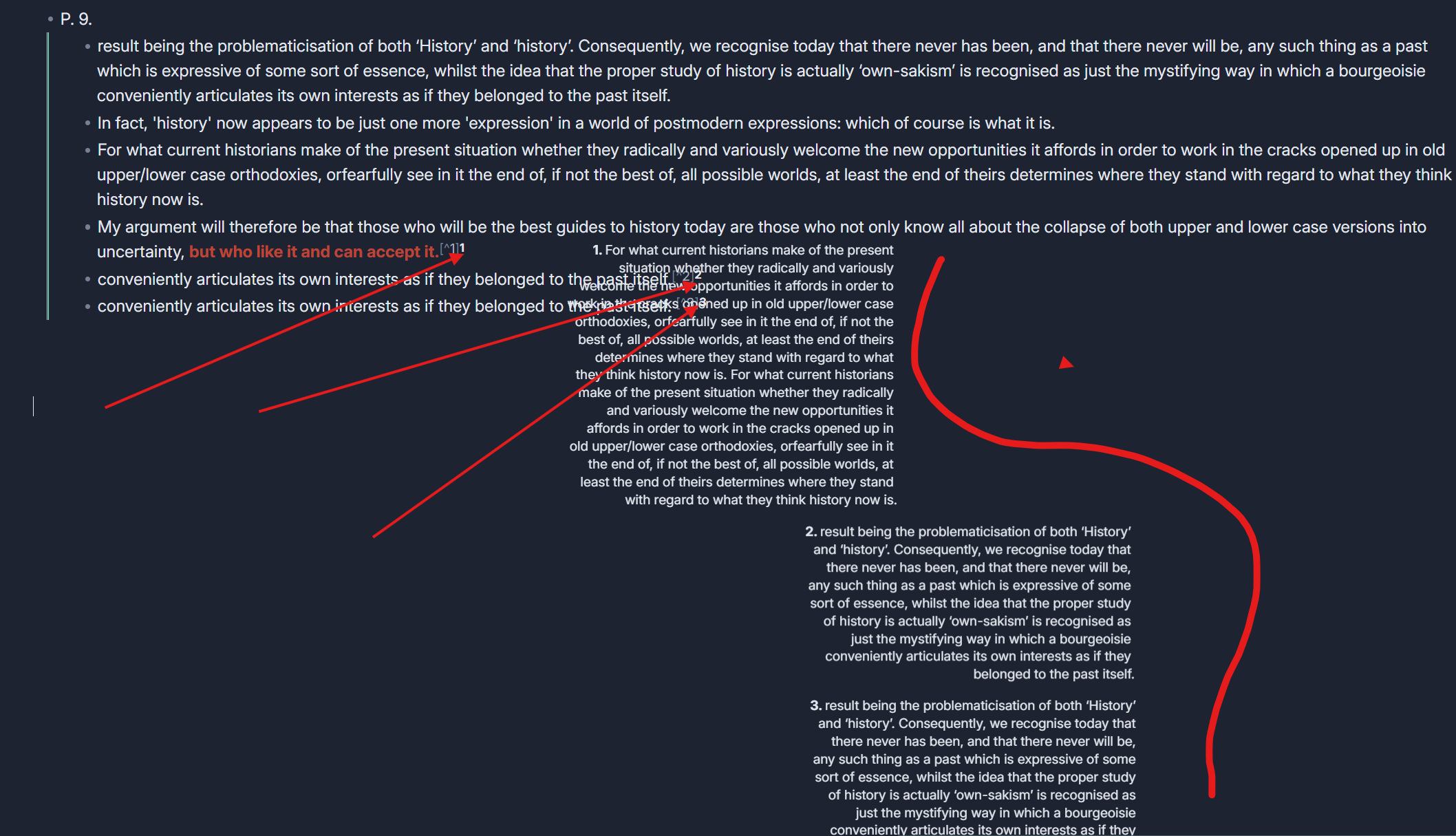

  4. If there is more than one footnote, there is a very severe shift in paragraphs and style. The maximum value of the Collusion spacing parameter is also insufficient. Only with a width of 52 does the display of side footnotes more or less align. Otherwise, this becomes a very big problem.
  5. It is not possible to edit footnotes in the sidebar on the spot, as is the case with regular sidenotes.
Yeah I’ll have to keep experimenting with converting footnotes. Sorry for the crappy implementation. I released that a little too quickly.

I mentioned this in the report, but I will also add to it. The parameters “gap between sidenote and text” and “Collusion spacing” need to be increased in any case, not only in relation to footnotes, but in principle for sidenotes. People like me, with widescreen monitors and stretched notes, will have problems with the text being too close. In theory, you just need to increase the values and the number of multiplied pixels or something like that in the CSS or JS files. I don’t think it’s difficult.

The new release, 0.1.5, hopefully fixes issues using footnotes.
It should hopefully work better in Editing Mode as well as Reading Mode. This includes being able to click on them and edit them in the margins (this only works in Editing mode because you dont edit in Reading Mode).
I also made it possible to increase the gap much more.
I also fixed some issues with Markdown processing (bold, italic, links, and code) when using footnotes.
Let me know if you see any issues or have more suggestions. Cheers.
I also added an option to anchor the sidenotes to the edge of the editor, as well as the original style of anchoring them to the note’s text.
