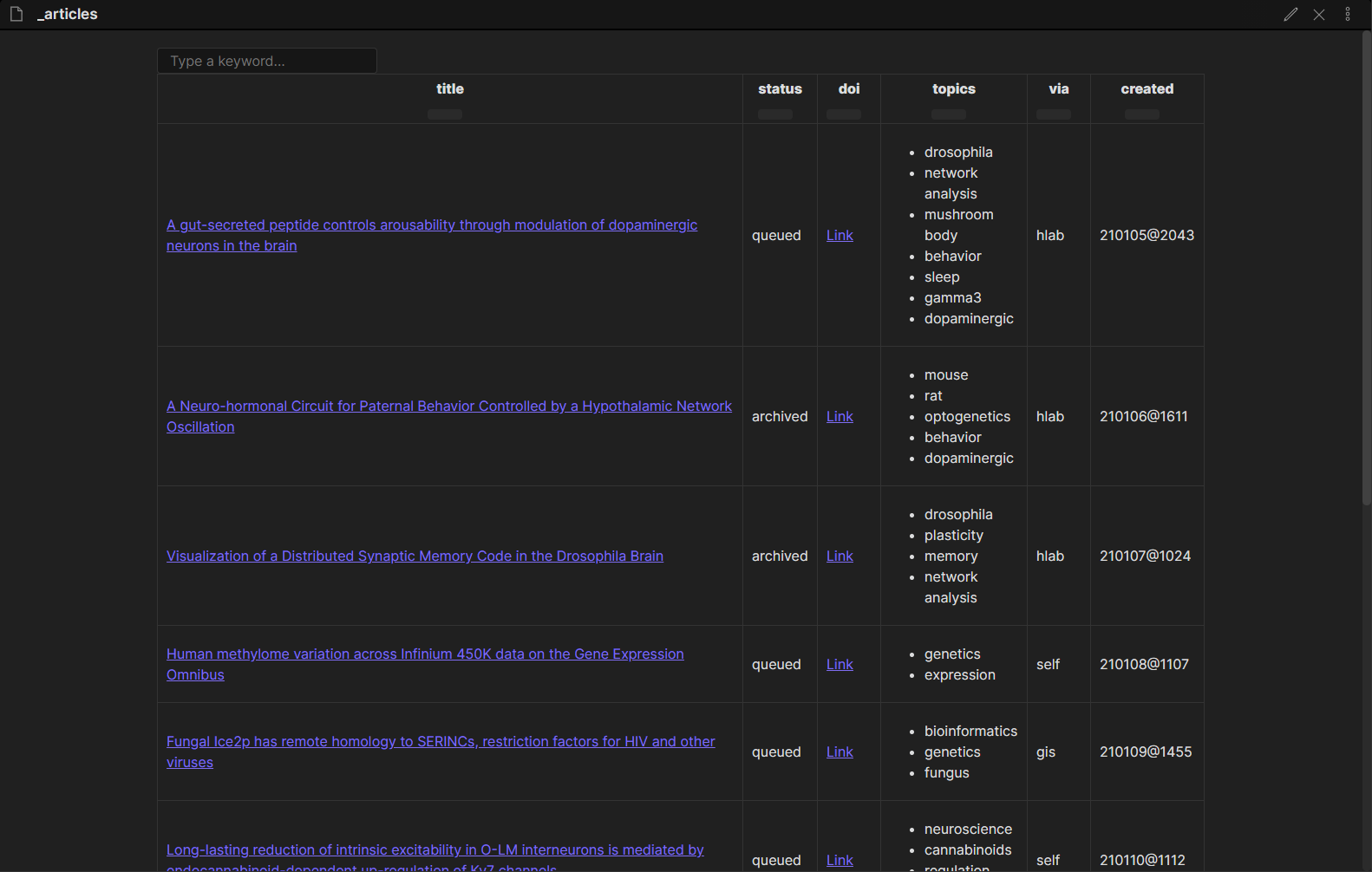

Table generation from query
This plugin allows you to output the results of a query as a searchable, sortable table of the frontmatter attributes from relevant notes.

Because of limitations within the Obsidian API, the only way to make the querying part of this plugin work is to run the query through the UI, then pull out the returned files. This means that whenever the query2table codeblock is rendered, you’ll see the search being run in your UI as well. However, there is some delay between the search being run and the files being output. If this delay is too short, you may not get all your files into the table. Adjust approxNumberOfResults as necessary to ensure that you get all your files without waiting too long.
Sample Output
Full Results
Search and Sort
