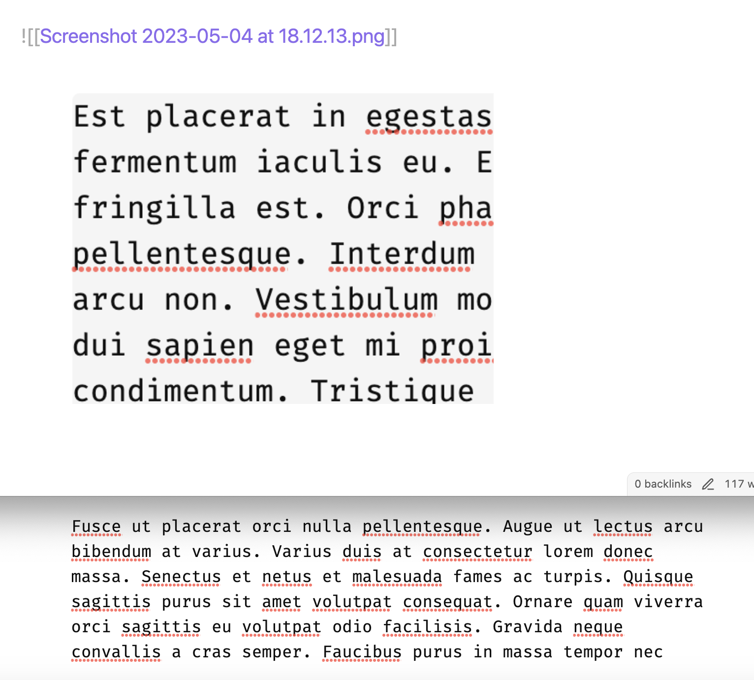

When I take a paragraph size screenshot, the screenshot is actually slightly smaller than the original area. I also usually have Settings > Editor > Readable line length enabled. This limits the editor size 700px wide.
But if I take a smaller screenshot(which I guess I don’t do as much?), it’s quite noticeable:

Using these steps in Preview (mac) I get this, which is smaller than the original area but more reasonable:
