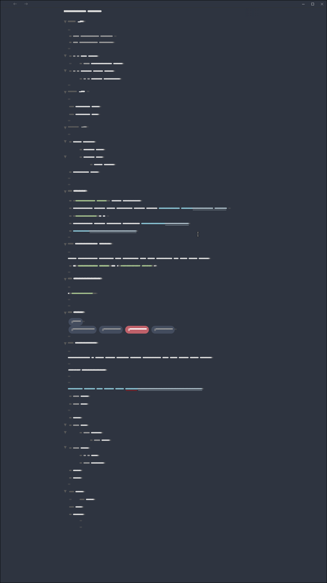

But this is using custom CSS, right?
In that sense what’s being shown in the screenshot is achievable with internal links too, especially because it has data-href attributes and these also have .internal-link .is-unresolved classes. Which allow for the same result you just showed, and I could argue even better, here’s a demo:
All these are internal links no usual # tags used:
[[tag new unexisting page]] <-- this is a tag without page created
[[tag important]]  <-- this is an important tag, unique color no page created
[[tag important with page]] <-- this is an important tag, unique color with a page
[[Ideas]] <-- existing page, this is not a tag
[[a page but not a tag]] <-- non existing page, not a tag
[[tag existing]] <-- this is an existing tag with a page for descriptions (if anyone likes that)
All tags are multi-word
And here’s how this very page renders:
And the css used is very small:
