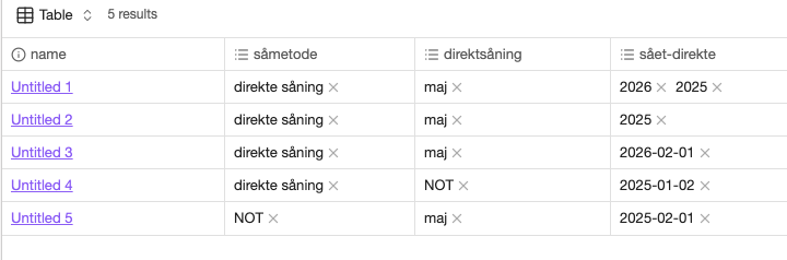

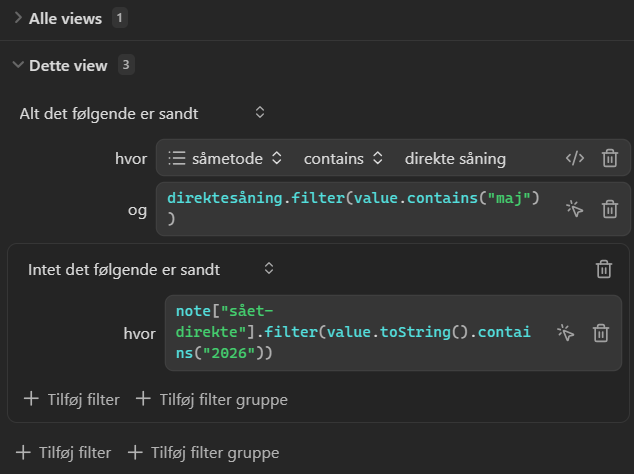

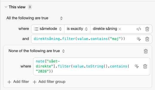

For some reason, this doesn’t work for me. I’m copy pasting what I have in my base now so you can see exactly what it is. My language is Danish, so I’ve translated the values to English here in the thread. I’ve tried using ‘aa’ instead of ‘å’ so the problem doesn’t stem from that character either.
I hope I did translate everything correctly. For me it still seems to work. Can you give me some examples where the filter fails for you?
Filter:
Before filter:
After filter:

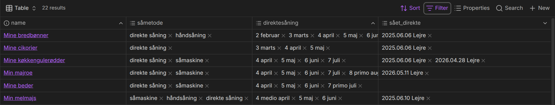

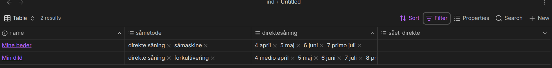

When I type in the filter it gives me the error: “Failed to evaluate a filter: Cannot find function “filter” on type String”.
Filter
Before filter
After filter
.filter() can only be called on a list type, not a string type. This means that one of your properties is not a list but a string type.

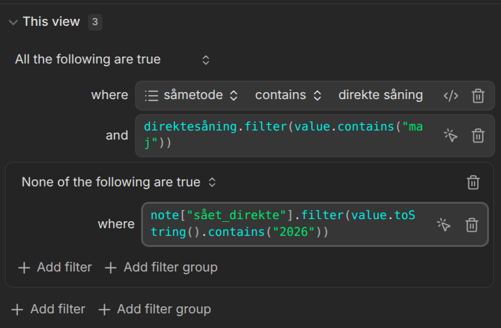

You can prevent the error by always ensuring that a property is a list when you call a list function. This means you should do list(property_name).filter().
For your case:
list(direktsåning).filter(value.contains("maj"))
list(note["sået-direkte"]).filter(value.toString().contains("2026"))
I don’t entirely understand the solution (the property in question is a list), but it worked!
Glad it works.
Yes, you assigned the list type to this property. However, there seems to be at least one note where this is not the case and the property has a single value which is not stored as a list. Thus all filters which use a list function like filter will fail on this note.
I cannot say what exactly caused this unexpected behaviour. I have encountered it several times, so now I always ensure in my formulas to use list() before list functions, which will convert a property to list type (or do nothing if it is already a list) to prevent this error.
