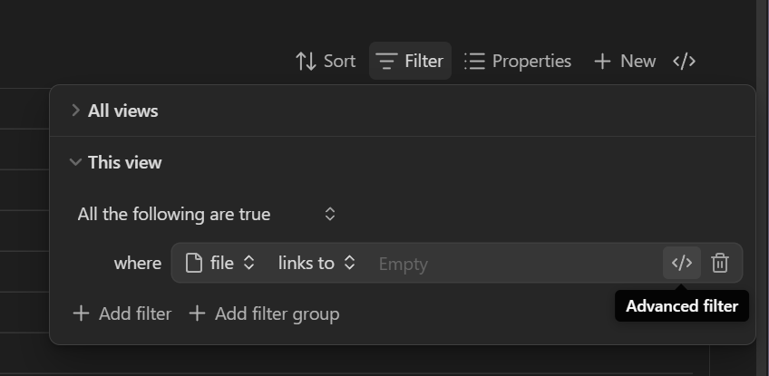

In your base interface, click Filter. In the popup, click the “Advanced filter” icon that’s to the right of the filter input box:

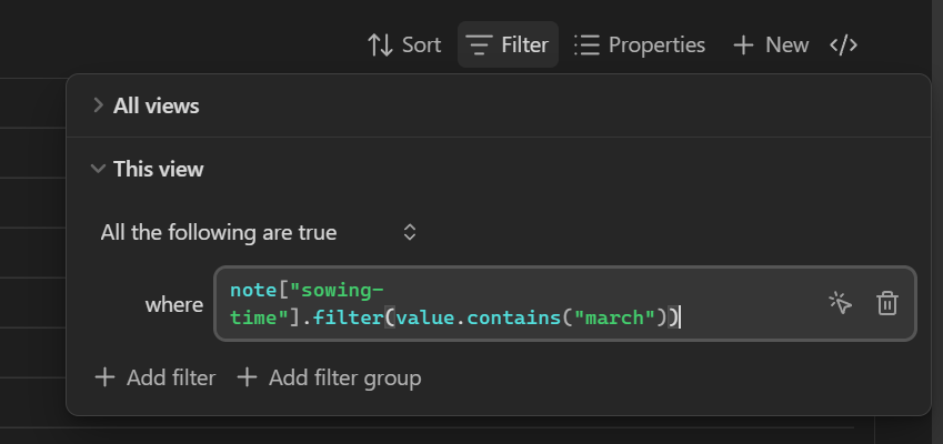

That toggles the filter mode so you can paste the code:
If you already did that and it still isn’t giving the results you expect, then can you describe what results you’re getting and show examples of your relevant Properties?
This worked! I wish this was possible to program using the simple code interface, but that would be a feature request. Thanks a lot.
