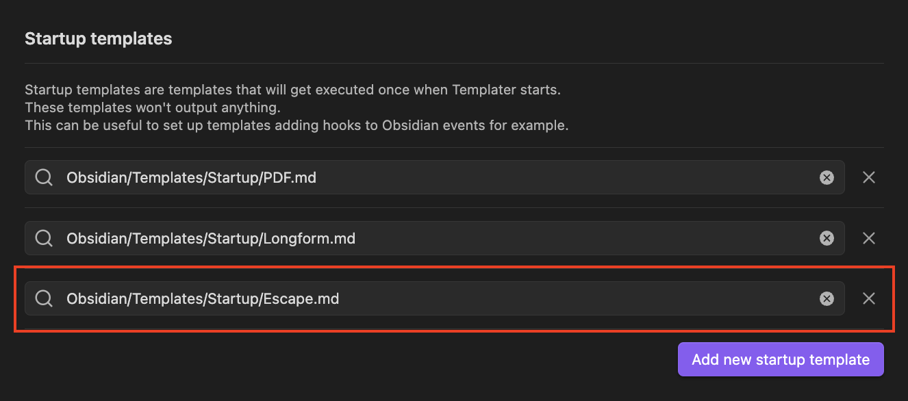

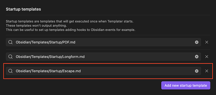

I set the following as a startup Templater script, and it worked! Hope it helps :slight_smile:
const scope = app.workspace.editorSuggest.suggests[0].scope;
const key = scope.keys.find(key => key.key === 'Escape' && key.modifiers === '');
const oldFunc = key.func;
key.func = (...args) => void oldFunc(...args);
oh man, where were you 3 years ago? Thanks!
