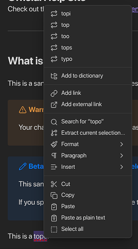

Keyboard triggered context menu does not show spell suggestions
Basically a reoccurrence of this bug
  • Open sandboxed vault.
  • Open settings, set HotkeysShow context menu under cursor to Ctrl + ..
  • Type “This is a topo.” at the end of the currently opening note.
  • Wait the spell checker to underlinetopo.
  • Use key to move cursor inside topo.
  • Press Ctrl + ..
Yes
Obsidian version: 1.12.7
Installer version: 1.12.7
Operating system: #1-NixOS SMP PREEMPT_DYNAMIC Sat Apr 11 12:26:52 UTC 2026 6.18.22

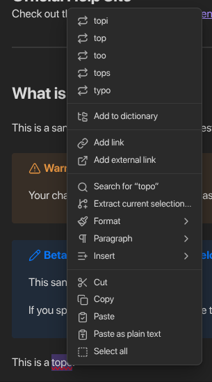

Seems that the difference between keyboard and right click triggered is that right click auto selects the wrong word. When I use move the cursor to the right of topo and press Shift + Ctrl + ← (this selects the word) and then press Ctrl + ., the suggestion shows correctly.
But this workaround is awkward (five keystrokes). I suggest also auto select the whole word when context menu is triggered near a typo.

Surprisingly, it works in Appimage. (but I have to say that there are even more other bugs in Appimage)
Sorry for the noise, this is again a strange Nix packaging issue. I should report this to nixpkgs.
Successfully fixed the issue by patching Nix deviation script. The glitch roots from Electron version mismatch. Thanks for your help.
