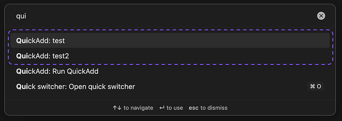

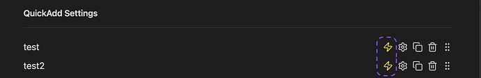

  • In QuickAdd settings, are you sure you registered the templates as a command (by clicking on their respective “lightning bolt” icon ?
  • Do the templates work (any of them) when you try to run them from the command palette ?
  • Did you try to create a button using Meta Bind button builder (available in the commande palette) ?
    You won’t have to look for the command ID using the button builder … Meta Bind will get it for you when you select the command it’s supposed to run :blush:
Note: I’ve tested this running the latest Catalyst/Insider/Beta release of Obsidian :blush: (So I don’t know if there could be issues using Obsidian latest public release :innocent:)
Woah. Your first code block finally worked for me! Woop!
Lol yeah, that was a copy-paste error, BUT I do still struggle with indentations, so that’s useful to double check. Thank you for pointing it out!
This might have been it! I didn’t have those selected. I might have considered that after another 2 hours of investigating on my own, but you’re a life-saver.
