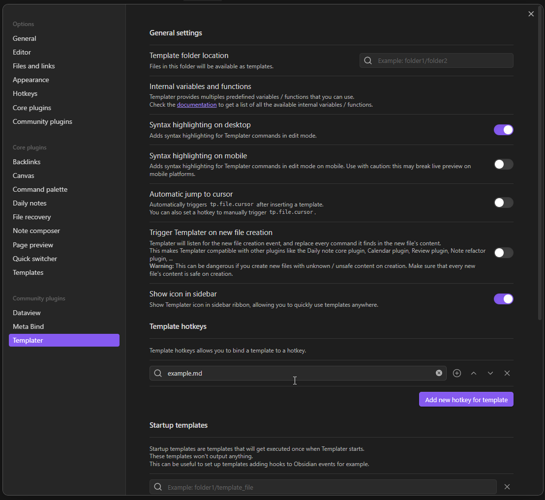

so here’s where you’d add your template to turn it into a command that the above metabind code can see and use:
You can add as many as you like with the “add new hotkey for template” button next to it

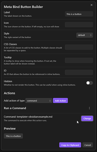

and here you can see the command shows up as one of the commands you can select in the metabind button builder
and you get this code on the clipboard:

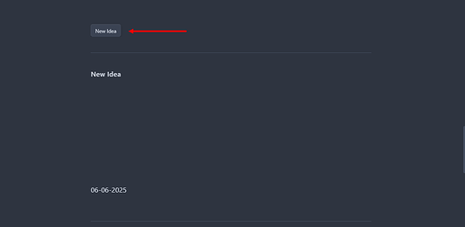

  1. For some reason, when the button is pressed:

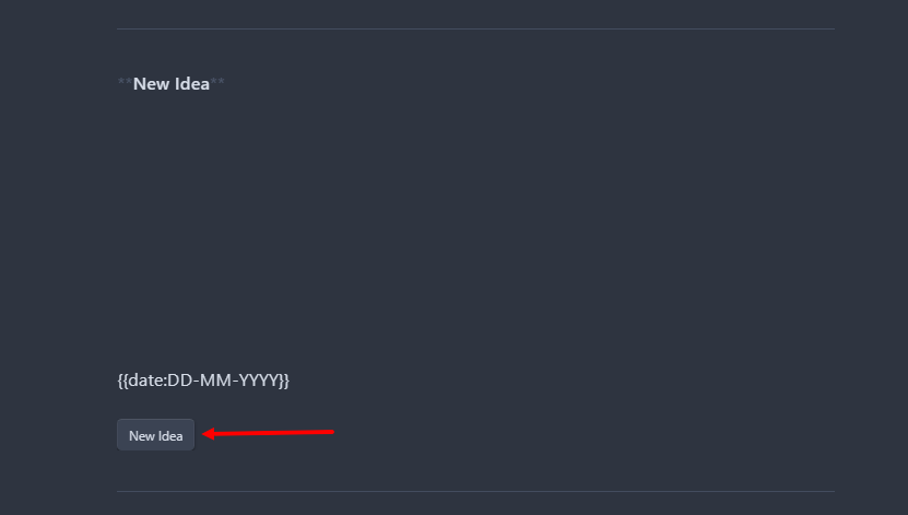

  2. The button shifts directly to the place where the template appears. But it should be static in one place, rather than shifting to another location.

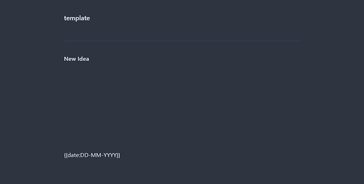

P.s. This is what my template looks like.
Sometimes, when button pressed, everything works fine. Sometimes the button shifts.
What could be the problem?
I think I got it!
The template is added at the place where the user places the cursor in the note.
Therefore, if you put the cursor in the wrong place in the note, then button will shift.
It was necessary to place the cursor below the button. And then click on the button!
