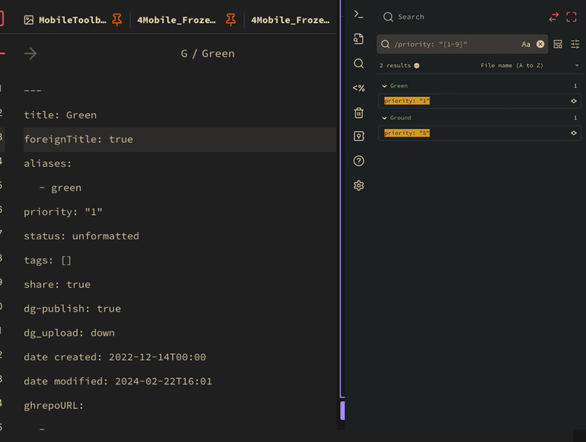

I cannot test now so I’m going blind here. Also, I’ve had issues in the past (probably sorted by now?) and used workarounds with regex syntax, so in your case /priority:[1-9]/ would be a good bet. But most probably you won’t be able to list the files by priority (only filename, dates, etc.).
You’ll need Dataview for that.
[Edited:] Thank you. It worked with [“priority”:3], for example, that brings all those with the value 3. But in the list, the values do not show and I did not figure out how to get them in order yet. But having the ability to have all those of one value only listed already helps greatly, thank you.
It’s not priority:[1-9] but /priority:[1-9]/ with the slashes (the last one is optional).
Yes, those quotes…properties queried in the search modal are treated/expected as text, not properties objects.
Thank you. But I somehow have not understood the “/”. When I enter [“priority”:1], I get the appropriate results. When I enter /priority:[1-9] or /priority:[1] or / /priority:1, be it with or without a / at the end, I get no search results.
Indeed.

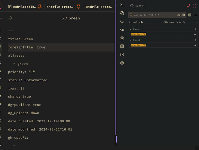

Well, first of all, one needs to check for the property field, whether it is stored as a number or a text string. If I add the property priority with 1 through the Properties UI, the 1 will be stored as "1". If I go into source mode and modify it to 1, then lint the file with Linter, it stays without quotes.
Also, the space was missing from my query.
/priority: "[1-9]" now works:

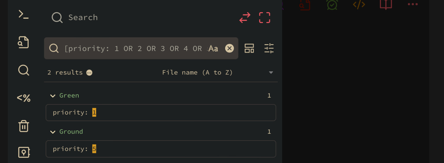

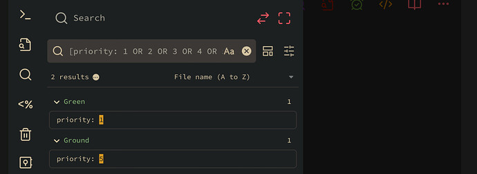

Entering [priority: 1 OR 2 OR 3 OR 4 OR 5] feels too much work as well, however one can save these queries to Bookmarks with a descriptive name.
That is interesting, now, it does work indeed. Yes, that is a strange behaviour of the programme.

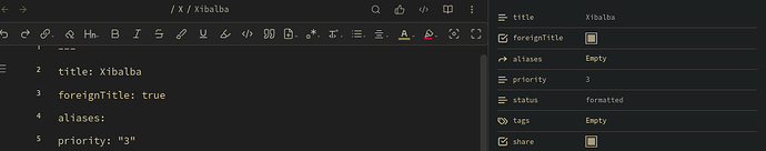

Okay, to make the triangle not show, you need to switch to number first and then enter the number.
Secondly, if you open a different note and add the property ‘priority’, the program seems to remember the type last used and will default to number instead of text.
Not only that, if you go back to notes where you previously added the number as text (because you forgot the need to specify number), the property icon is changed to number, but because you entered the value as text, the triangle is shown. Removing the quotes now in Source Mode will make the triangle go away.
Conversely, if you entered the number 1 as number and change to the type to text, the triangle appears.
