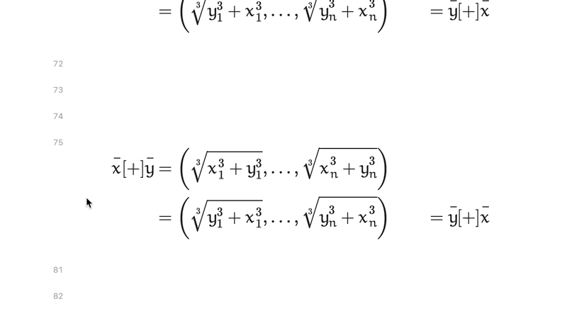

I installed Neo Euler on my device (macOS), closed-opened the vault for good measure, and this is working on my end (for example):
mjx-math .TEX-I {
font-family: 'Neo Euler';
.mjx-i {
font-style: italic;
I’m not too familiar with using CSS to adjust MathJax, but as you can see there’s a whole lot you can target. (apologies for the flashy gif)

I took a look using the CSS inspector. For a more comprehensive font change, all of these need to be changed.
mjx-math .MJX-TEX {
font-family: "Euler Math";
mjx-math .TEX-B {
mjx-math .TEX-I {
mjx-math .TEX-MI {
mjx-math .TEX-BI {
mjx-math .TEX-S1 {
mjx-math .TEX-S2 {
mjx-math .TEX-S3 {
mjx-math .TEX-S4 {
mjx-math .TEX-A {
mjx-math .TEX-C {
mjx-math .TEX-CB {
mjx-math .TEX-FR {
mjx-math .TEX-FRB {
mjx-math .TEX-SS {
mjx-math .TEX-SSB {
mjx-math .TEX-SSI {
mjx-math .TEX-SC {
mjx-math .TEX-T {
mjx-math .TEX-V {
mjx-math .TEX-VB {
However, changing all the fonts to Euler Math does not work all that well.
Euler Math has all the following available.
Replacing all the font families with Euler Math produces this.
By default, each of the classes have font families set to these.
