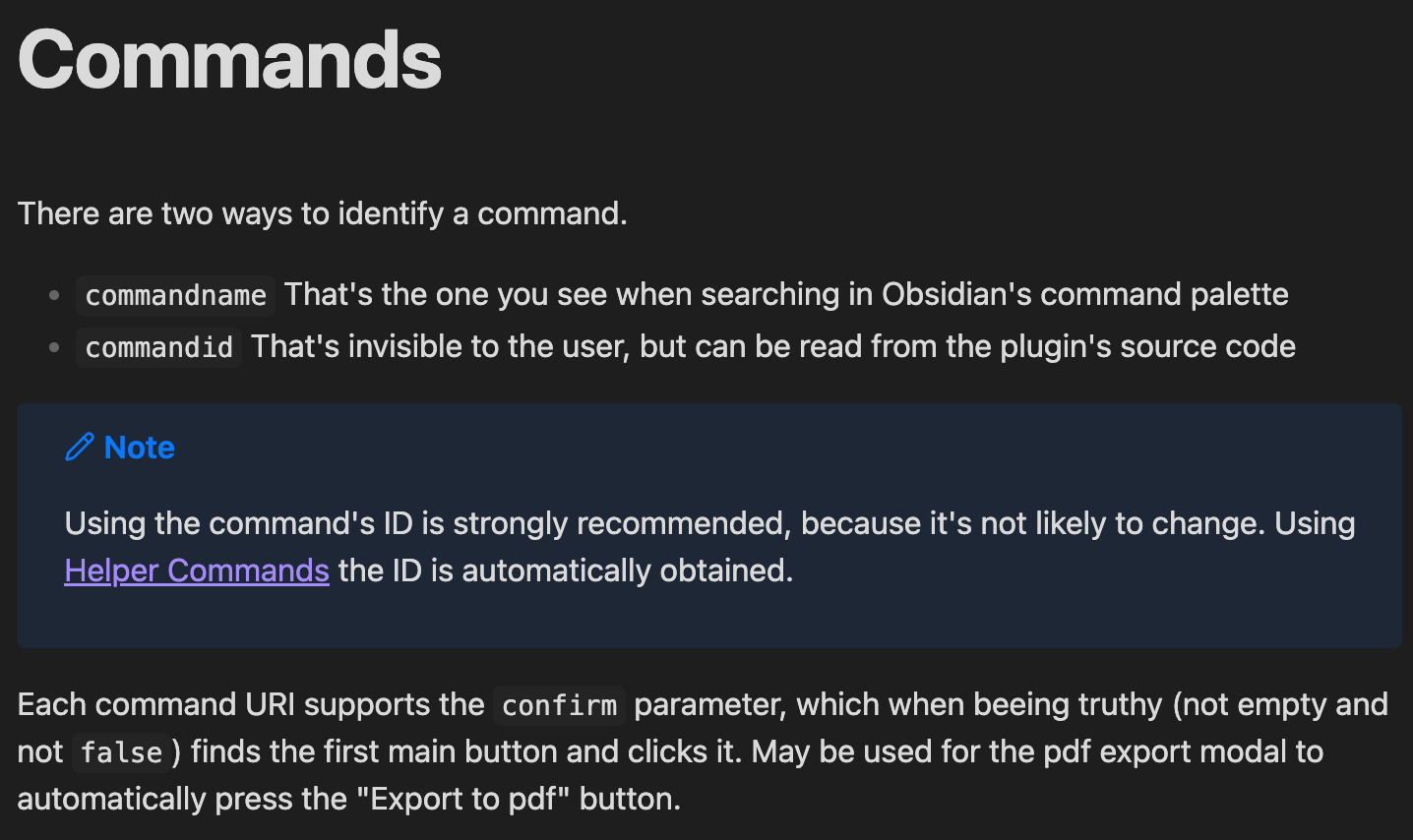

Advanded URI also implemented confirm parameter which clicks the “export to pdf” button.
# mac
open "obsidian://adv-uri?commandid=workspace%3Aexport-pdf&confirm=true"
# linux
xdg-open "obsidian://adv-uri?commandid=workspace%3Aexport-pdf&confirm=true"
# powershell
Start-Process "obsidian://adv-uri?commandid=workspace%3Aexport-pdf&confirm=true"
https://publish.obsidian.md/advanced-uri-doc/Actions/Commands
Well that’s also pretty handy. Unfortunately even using this approach you still have to manually choose the filepath and click “save”
