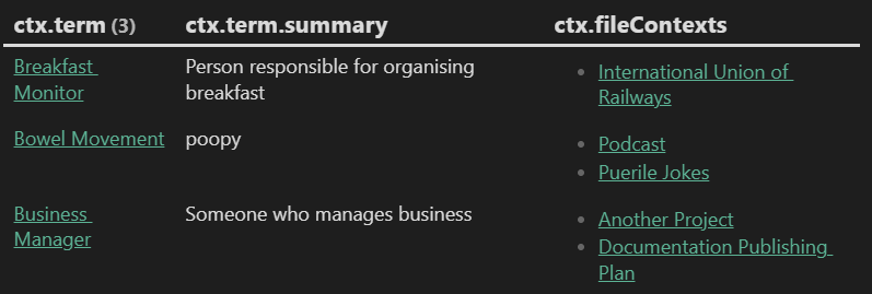

Then in the body of the abbreviation note I can put this:
```dataview
TABLE WITHOUT ID ctx.term, ctx.term.summary, ctx.fileContexts
WHERE file = this.file
FLATTEN contexts as ctx
Which displays the uses of the abbreviation in the various contexts:

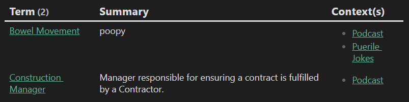

Now in the document or other context requiring a list of abbreviations relevant in that context, we canb have this:
TABLE WITHOUT ID ctx.term as "Term", ctx.term.summary as "Summary", ctx.fileContexts as "Context(s)"
FROM #abbreviation
FLATTEN contexts AS ctx
WHERE contains(ctx.fileContexts, [[Podcast]])
(note that “[[Podcast]]” is not in quotes in the WHERE expression. That was the problem before.)
I could even skip the column showing contexts, because we know the abbreviation is relevant to the current context, and we may not care what other contexts it’s relevant in.
All working well now, thanks!
