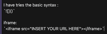

I keep getting a video unplayable “Error 153” message when trying to embed a YouTube video.
I have tries the basic syntax :
iframe:
<iframe src="INSERT YOUR URL HERE"></iframe>
and the commnity plugin convert URL to preview all with the same result.
It seems like some other users have had this issue and the responses are “Well it works for me”. I’d appreciate some help on this matter. Thanks!
