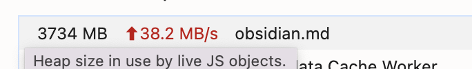

I’m seeing new record numbers with the latest version.
I tried to 5 times to make an edit to the file but it crashed every time, so I now have to make edits with a different editor on that file.
later edit - this happened while trying to add an embed with ![[#^typing-ref...]]
Concerns
  • reindexing the whole file is unnecessary
  • reindexing on individual keystrokes is unnecessary. At a minimum it should be at word or paragraph
