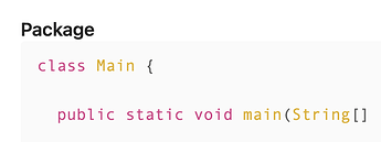

I want to reduce the space between the code block and the normal text paragraph.
I tried a few ways, but all of them didn’t work. Can anybody help?

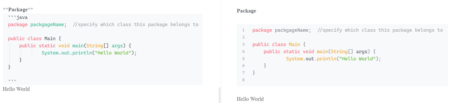

The left side is the source code, and the right side is the preview.
Is there any way to reduce the space between the code block and the text as there is a big gap between them?

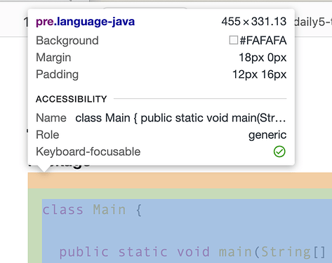

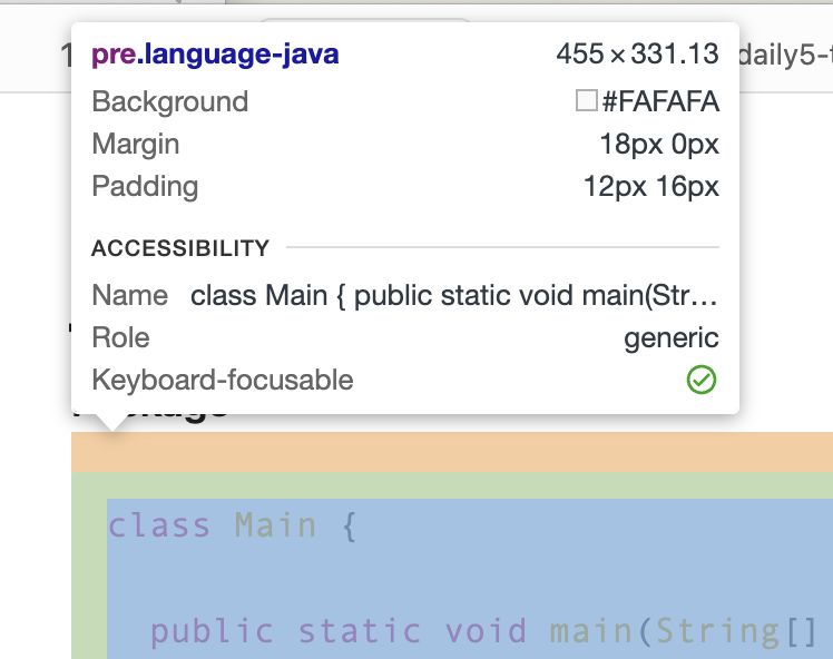

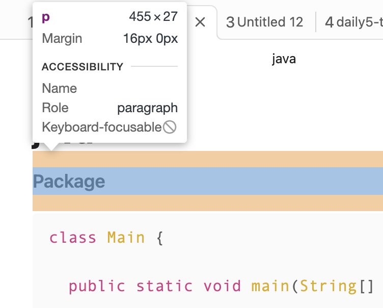

In Reading view, p elements have a top/bottom margin of 16px. Code blocks, pre elements, have a top/bottom margin of 18px. It’s easy to remove the top margin of pre, but then you have the leftover 16px from p elements to deal with.

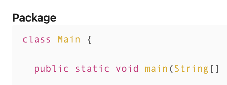

So, in this case to get around that, a negative margin could work. This selects code blocks that follow paragraphs.
.markdown-rendered div:has(> p) + div:has(pre) {
    margin-top: -20px;
You could give that a try.
It works thanks!!!
