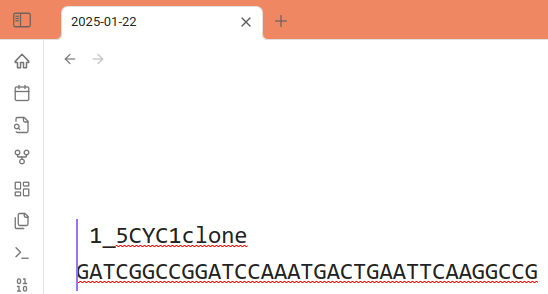

Edit preview, No “>”
edit_preview
Edit preview, cursor on the first line “>”. Here we can see the “>”
edit_preview2
Source mode, “>” visible at all times.
source_mode
I would like to see the “>” as in the second example all the time.
