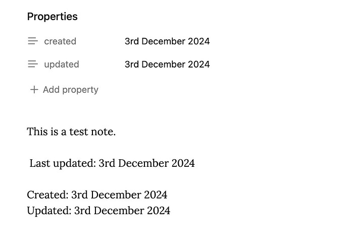

Hopefully, my last post explains what I’m trying to do and what I’ve been able to achieve and the screenshots will help. I have now found a way to insert the frontmatter into the body of a note, in the same way as you describe using Dataview.

I have tried both Meta Bind and Dataview approaches now, both with the same result.
In both cases I can insert the frontmatter data in to the body of a note.
Meta Bind and Dataview results:
However, in my Obsidian Publish site, only the source code is rendered, not the result that appears in my vault.
