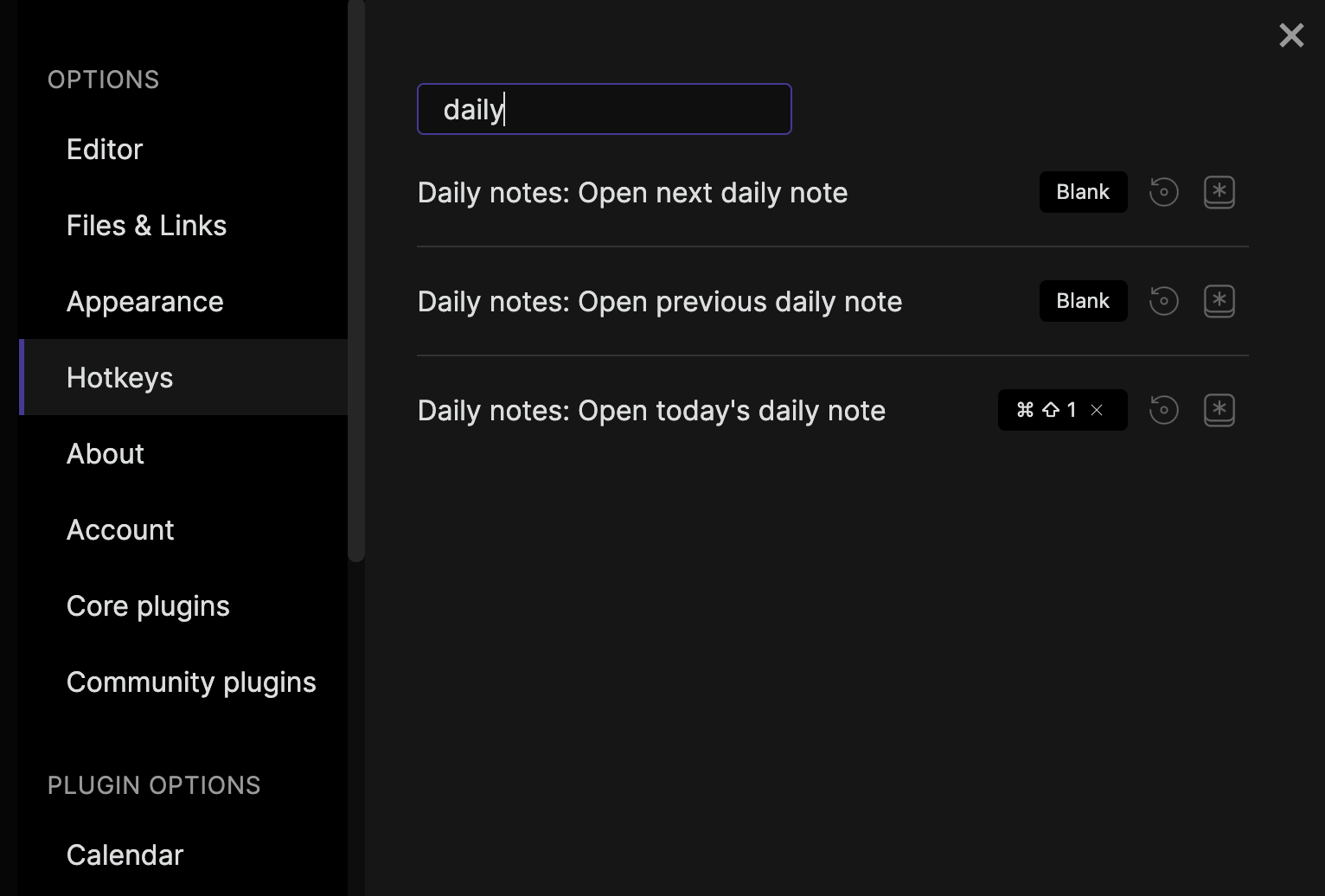

Post a screenshot of your settings.
This is how I have mine set up.
