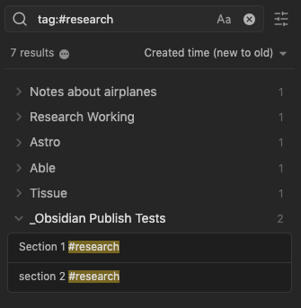

EDIT: Basically what I’m trying to achieve is something similar to this, but instead of using the Search, I would like to have a note that gathers all that info:
Again, I’m using a tag as an example, but if there’s another way of achieving this, please feel free to share it.

I didn’t see it mentioned, but have you tried an embedded search/query yet? e.g.
```query
tag:#Research
You can also click on the right to expand the results and “Show more context”:
There are two plugins, Query Control (beta – installable via BRAT) and Better Search Views that extend the built-in functionality.
With Better Search Views installed:
This is an awesome solution and super simple to implement!
Really appreciate you sharing it :raised_hands:
And unlike using the dataview option which opens the note separately and doesn’t allow going back to the original note (the one that shows the list of all files with the hashtag), this approach allows me to do that.
