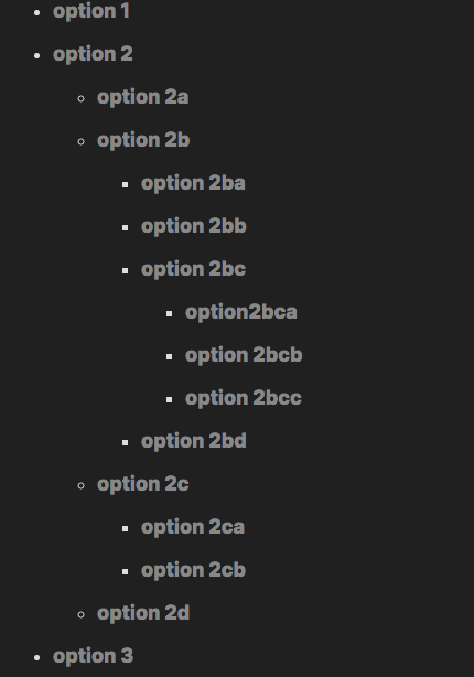

Ah I see. Yeah I guess nested/indented headers for me allow for some visual communication but they could have some visual polish to be more useful/friendly. Here’s an example of a list of indented headers I tested
I’m all for flexibility for the users so a convert to what you suggested would be a welcomed option, alongside setting up auto indenting/headers on indents, etc.
