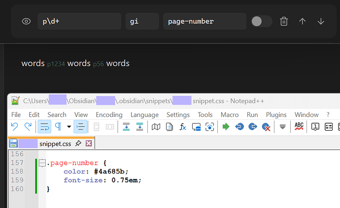

I wanted to be able to write the regex as just “p\d+”, but the CSS snippet didn’t work. I assumed it was because it needed a symbol (@, or ~ or /, etc.) in front of it but I’ve tested it a bit, and I can’t get anything to change the colour with p\d+
I’ve currently got this in Regex mark:
And this snippet active:
.page-number {
    color: #4a685b;
    font-size: 0.75em;
And it’s not affecting anything with a “p” followed by numbers.
I’ve also tried “@cite, p\d+” and “p\d+” and I’ve tried with other delimiters like “/p\d+” and “~p\d+” but none of them have changed the colour. The other CSS snippet I’ve got (“@\w+”) is working, so I’m not sure what the issue is.
Try refreshing the note to make the styling apply.
(Some ways to refresh: Close and reopen the note. Or go to another note in the same tab then go back to the note. Or do Reload app without saving in the command palette.)

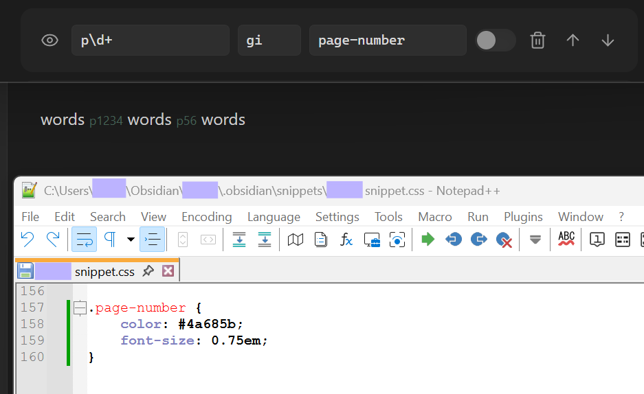

Don’t know if this is in play too, but gonna point out that on some screens, it might be tough to see the difference between gray #4a685b and the default font color when you’re in light mode.
Also, I installed the plugin to confirm, and the regex you came up with is solid. p\d+ works:
For some reason, it’s working now that I’ve put the code into its own CSS snippet, instead of with other ones. I’ve never had that be a problem before, but at least it works now.
