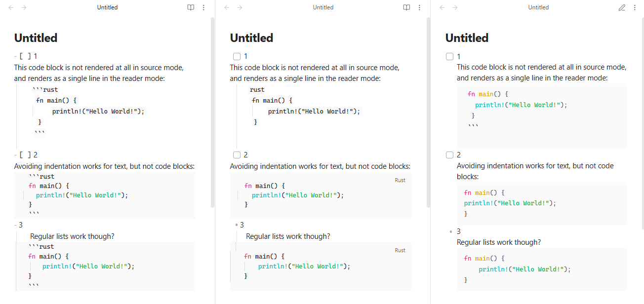

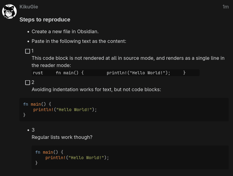

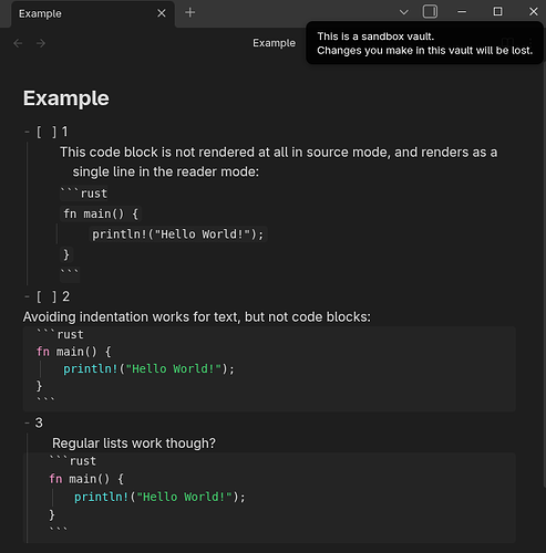

Code blocks in task lists look broken
  • Create a new file in Obsidian.
  • Paste in the following text as the content:
- [ ] 1
      This code block is not rendered at all in source mode, and renders as a single line in the reader mode:
      ```rust
      fn main() {
	      println!("Hello World!");
- [ ] 2
Avoiding indentation works for text, but not code blocks:
```rust
fn main() {
- 3
	Regular lists work though?
	```rust
	fn main() {

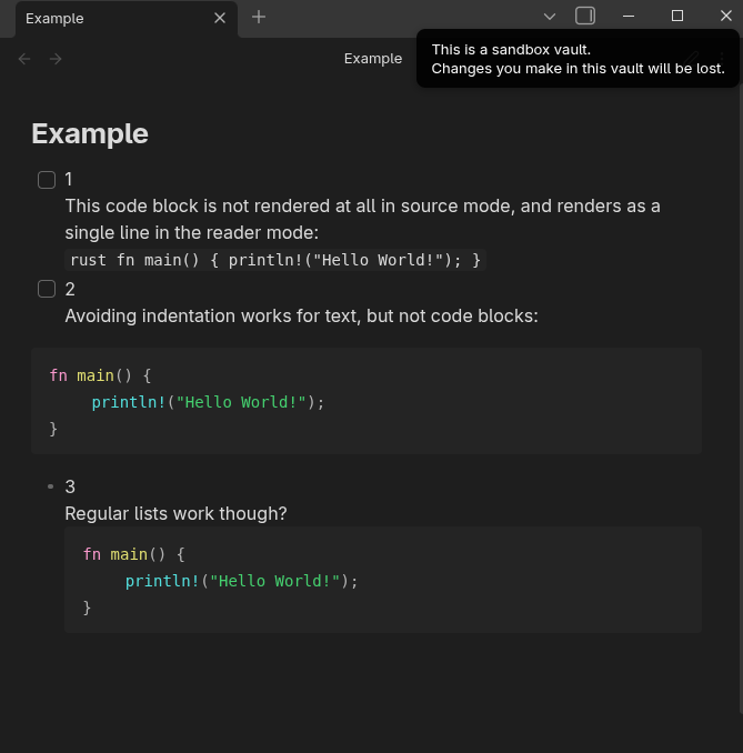

Yes, it was tested without any plugins or themes in sandbox on version 1.11.5.
See screenshots below.
The code block in the first element of the list should look like in the third.
When indented after a - [ ] list element, the code block rendering is broken in source and reader modes.
Obsidian version: v1.11.5
Installer version: v1.11.5
Operating system: #1 SMP PREEMPT_DYNAMIC Sat, 31 Jan 2026 04:46:44 +0000 6.18.8-2-cachyos

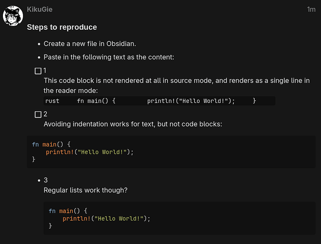

This issue is even present on the web view…

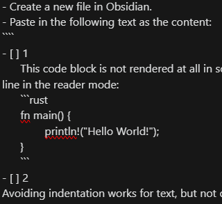

I put your entire example between four backticks so all of it was shown properly in the fourm:

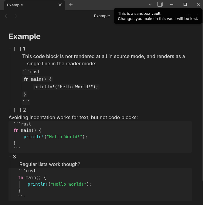

I was able to get it looking alright in Reading view with this spacing:
- [ ] 1
     ```rust
      fn main() {
- [ ] 2
   ```rust
   fn main() {
- 3
	 ```rust
	 fn main() {
