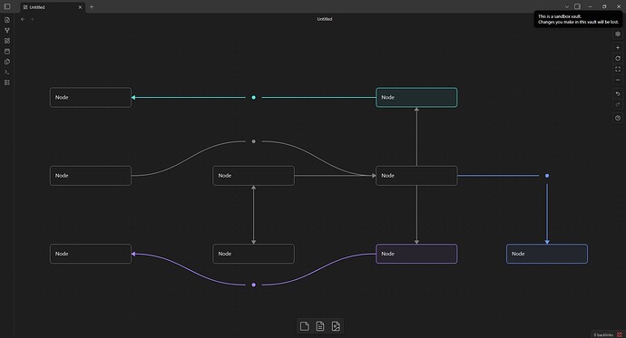

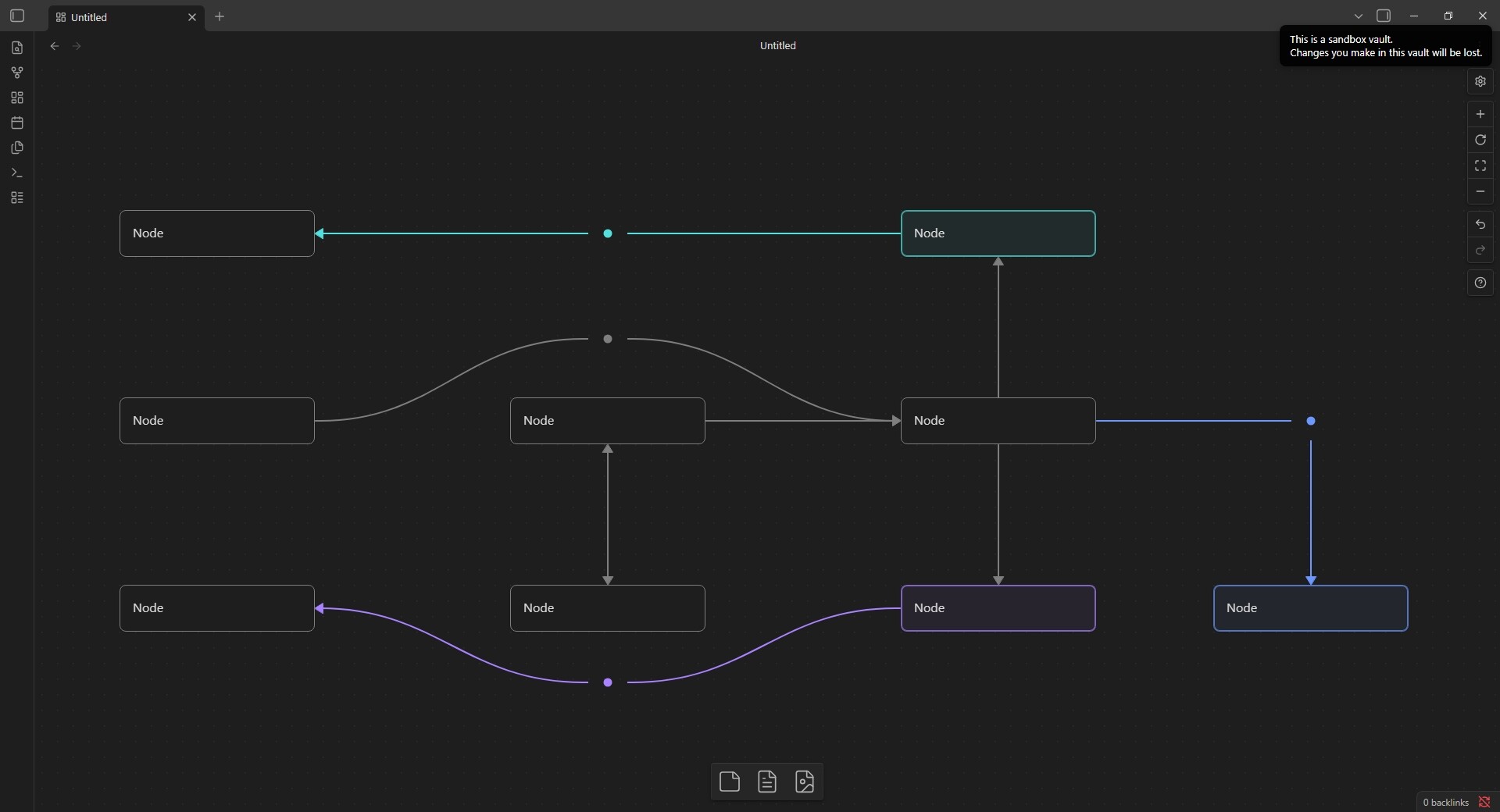

A small workaround.
When a node is scaled to 50x50 pixels (minimum size), its background disappears and a circle appears in the center, imitating a Reroute Node.
It seems that it is not possible to make the boundaries of the outgoing/incoming arrows touch the boundaries of the dot, i.e., to move them slightly away. Therefore, unfortunately, it is not possible to get rid of the small gaps.
As a workaround, you can make it so that when you select a certain color, a line is drawn from the center of the node (point) to the specified border, and simply go through all possible node connection options in this way, but this seems to me to be too cumbersome a solution, which, moreover, will be inconvenient to use in practice. Therefore, I prefer to put up with the small gaps.
The CSS has just been created, and not all usage scenarios have been tested in practice, so there may be some issues.
Color support, including custom colors, seems to be working.
CSS Snippet
