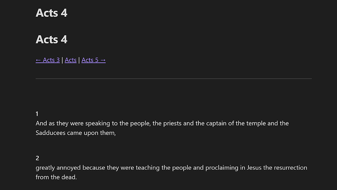

Here is another example where at the beginning of Acts 4 it seems to not include “Peter and John Before the Council.”
