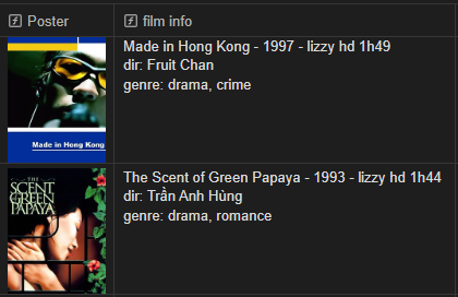

How can I separate multiple fields in table.base propertie using a new line? I’m using table view with the cover art in the first column, which leaves lots of vertical space next to it for all in the info I need. I’ve tried all the ways below (in various forms), to no avail.
file.name <br>
director \n
genre char(10)
viewed <\br>
Similar:
use an array! eg the formula [ [1], [2], [3] ] displays 1, 2, 3 on separate lines.
That worked! Thank you.
The formula:
[ [file.name], ["dir: "+director], ["genre: "+genre] ]
The result:
