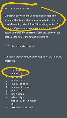

Although in the original DaringFireball syntax linked from the page you linked, it specifically states that the backslash escaping should work:
https://daringfireball.net/projects/markdown/syntax
Where? Can you point it out? I only see an agreement:
To include a literal backtick character within a code span, you can use multiple backticks as the opening and closing delimiters:
As the “literal character would otherwise have special meaning” (close the inline code block), sounds to me like it should escape it.

The part you quoted says that you can use double backticks. It does not say you can’t escape them, unless I missed that.
“Markdown allows you to use backslash escapes to generate literal characters which would otherwise have special meaning in Markdown’s formatting syntax” sounds pretty clear and straightforward.
