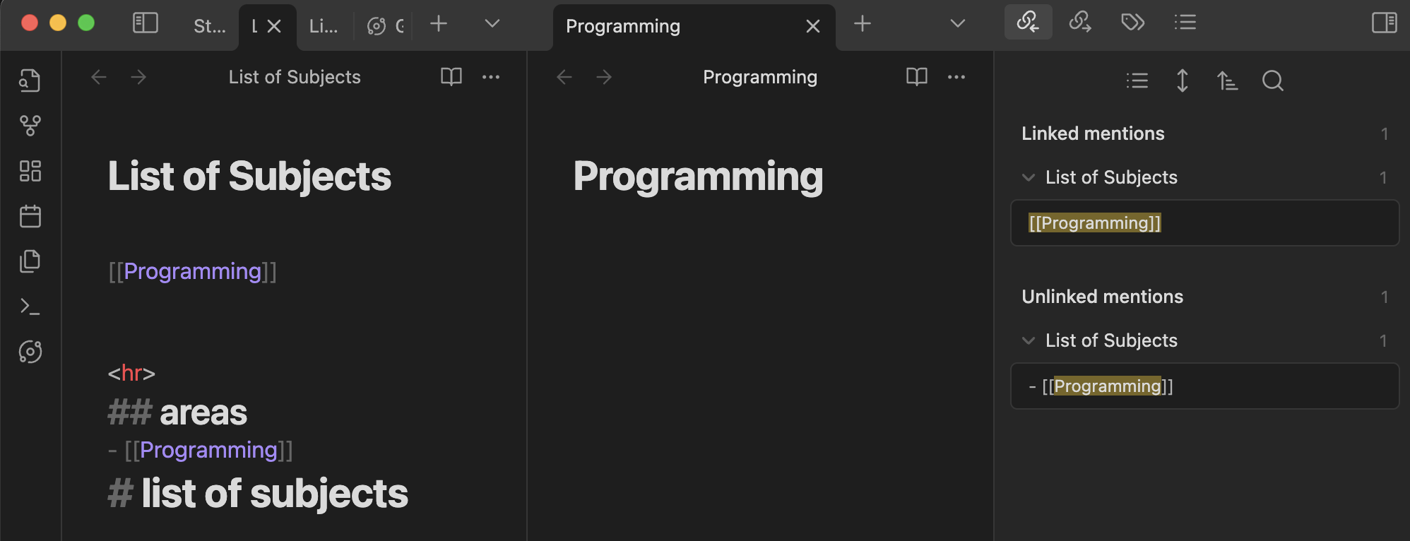

I appear to be having an issue with the backlinks panel where links that should be linked are showing as unlinked mentions. My issue seems to be similar to the one described in this Obsidian forum post from 2020. I’ve mostly relied on folder structure until now so I haven’t noticed this issue previously for lack of needing to check until now.

As demonstrated in this screenshot, links instead appear under unlinked mentions in the backlink tab. What is most strange is that the correct format is shown in the preview of unlinked mentions… [[Note]].

Looking at the preview of the List of Subjects note, it looks like you’ve got some HTML in there not separated by a blank line. Block level elements need to be separated by a blank line. That seems to be throwing off the editor/parser.
<hr>
## areas
- [[Programming]]
# list of subjects
Try adding a blank line above and below the <hr>, e.g.
<hr>
## areas
- [[Programming]]
# list of subjects
or skip the HTML all together and use Markdown for a horizontal rule:
## areas
- [[Programming]]
# list of subjects
